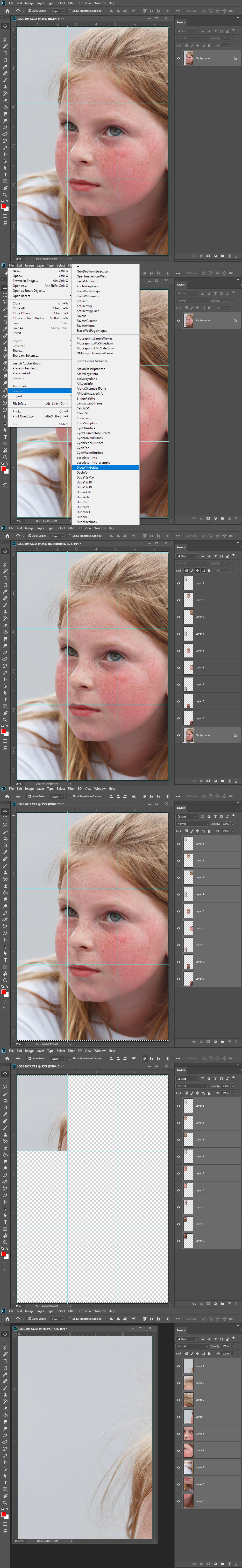

How to slice a very large poster
I am designing a few posters for my architectural presentation, I have 6 posters each are 90 cm x 237.8 cm. I am trying to design them all in one file so that they are connected so in total the width is around 5.4 m. I divided them using the slice tool but I don't know how to export each one to a seperate file. The save for web option is greyed out.

Instead of slicing the image with with  the slice tool.  I would set guide line to how I want to dice up the image and then use a script to dice the image into those guides as layers. You could then use export layers to files. You can also set the guides via a Script or action.  Here I Open a RAW file as portrait Image. Set Guides. Then ran the script. I then deleted the background layer. Did a select all and targeted all layers and align all the layer to the top left. And then used image trim. All the sections you want as files are in a layer stack.  You could actually record an action to automate all the steps I showed.

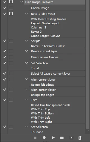

Here an action them. The Guide layout step is interactive you can cnange the layout. The Step I recorder defalts to a 3x3 grid.

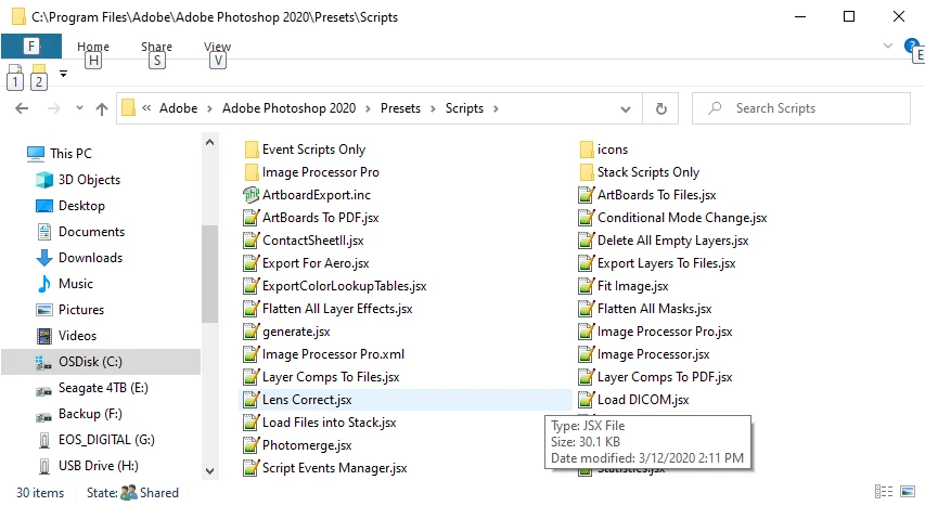

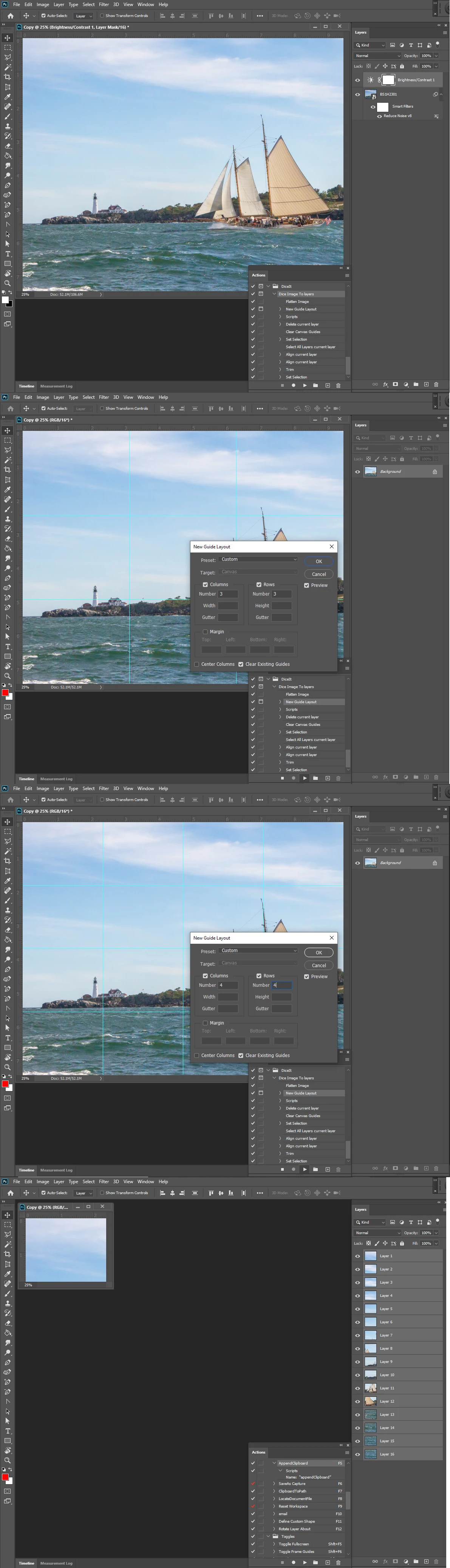

March 24, 2020
You ma use many scripts currently that you did not write.  Adding an other you did not write is no big deal.
Here is what ship with Photoshop the only one I add there is Image Processor Pro.  I keep all the rest I use elsewhere.
Actions are easy to record.  To use a script in an action you record menu File>Scripts>Script Name
