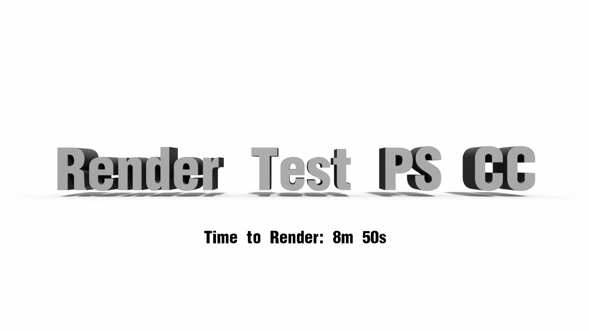

    I have the following system specs
    OS Name Microsoft Windows 10 Pro
    Processor Intel(R) Core(TM) i5-6400 CPU @ 2.70GHz, 2701 Mhz, 4 Core(s), 4 Logical Processor(s)
    BIOS Version/Date American Megatrends Inc. P1.40, 2016/06/16
    Installed Physical Memory (RAM) 12,0 GB
    Total Physical Memory 12,0 GB
    This render was done in PS CC. As you can see, it is super simple
    A total time of 8m 50s is unacceptable

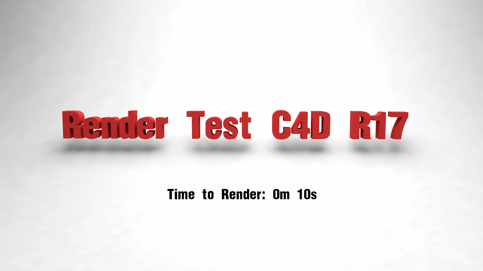

    I decided to try the same type of Render in Cinema 4D R17. This is my go to 3d software which I have used for years. I kept it simple, used a material to light the scene off a plane, and set Global Illumination to HQ Indoor. I also included an infinity screen, all of which adds complexity to the scene. This is the result:
    As you can see, this render took on 10 seconds.
    With this test in mind, I have to agree with Mylenium. If you want to do some serious 3d work, PS is not the way forward, but if you need a simple 3d element for a once off job, then the tool is available to you. It is possible to edit video in PS, but in production, I don't think anyone will use PS for this task, but would rather use Premier. The rule applies here, just because the feature is there, does not mean that it is suitable for production.
