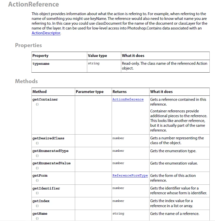

To toggle all the smart fitters on a smart object layer you would need to get the current state of the visibility icon by the layers  filter mask then change that state. The Scriptlistener only seems to record executeAction  steps like you show.  To show and hide.  You  would need to get to do some executeActionGet(ref) for the layer or perhaps the active to get the current state and the use the correct setting "Shw " or "Hd  " in the executeAction( ?) step.  The code you show one step Hide seems to idenyify the layer name the Show step must be for the current actuve layer I see noe layer name.
I do not knonw how to write the executeActionGet(ref) part I always search for code where other have coded that part and steal(reuse) their code.
