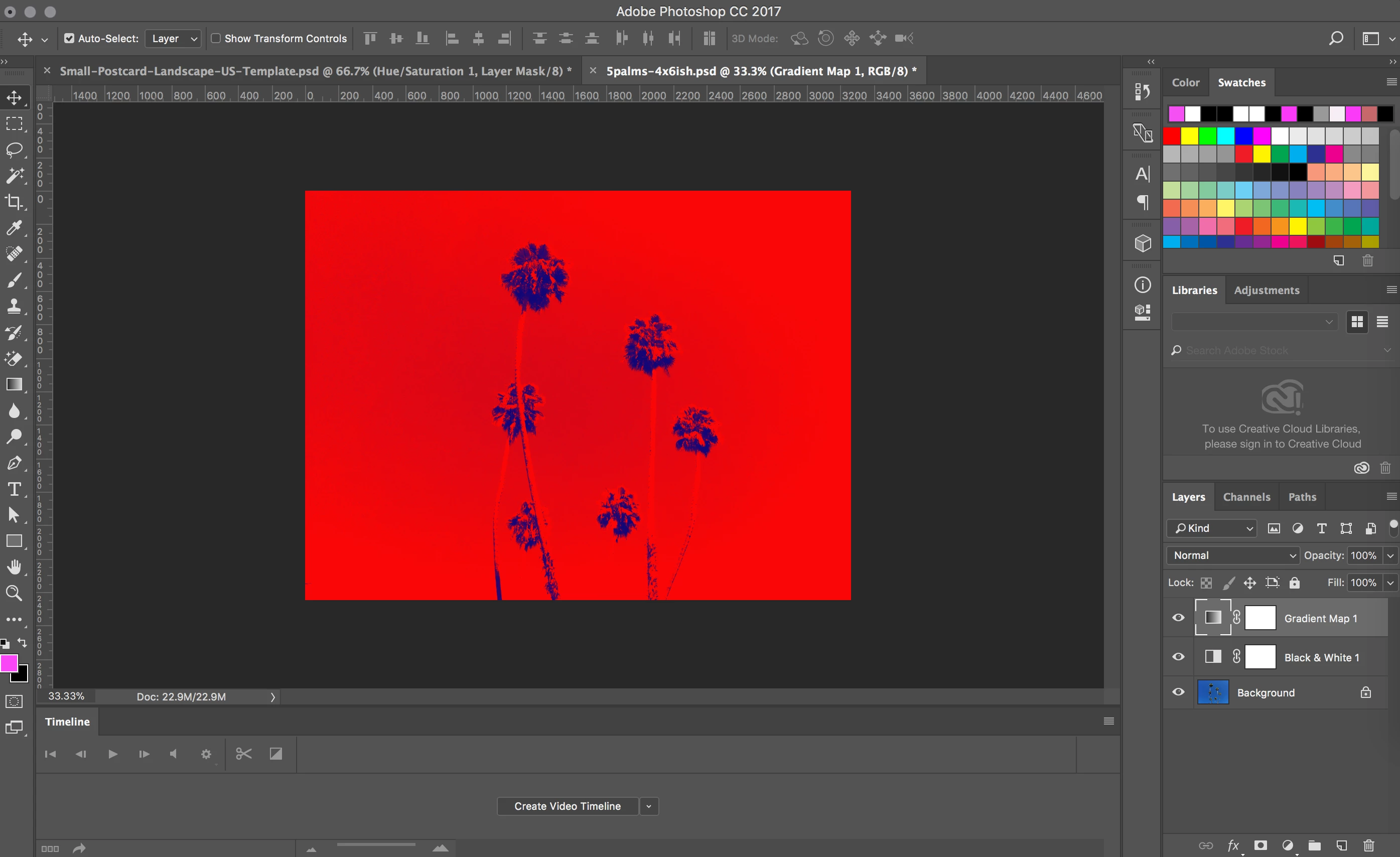

I have a file with an RGB image to which I've applied several fx and filter layers. Black & white, and Gradient.
See the screen grab below.
I need to have the same visual, but in CMYK, at a different DPI, and at a smaller size, but not an identical aspect ratio.
I'm not clear whether I should A) convert the RGB to CMKY, then resize the doc, or B) create a new CMYK file at the new dimensions, import the same source photo (layer Background in screen grab), and transfer the layers over. (I could also simply redo similar layers on the new doc, but I'm having a hard time recreating the same effects, as I can't find where the settings are detailed.)
For option A
When I try to convert  RGB to CMYK, an alert says it won't be able to transfer one of the layers due to the change. I assume this is the Black & White effect because that one isn't available in CMYK files.
So if I lose that layer, then it doesn't solve my problem.
For option B
I've created a CMYK file with the new dimensions and dpi, and imported the source photo. All good there.
To bring the fx and adjustment layers over from the RGB file, I read an article stating to create a duplicate of each layer in the RGB file, and send it to the new CMYK file. However, the new document doesn't show up as an option. I'm assuming because of the different formatting.
So not sure if it's doable or not, but I'd like to be able to get the RGB file look to a CMYK file with minimal loss to image quality.
Any suggestions on the best way to do this would be greatly appreciated.

Correct answer davescm
The adjustment layers in CC2017 and CC2018 are the same.
The black and white adjustment layer is the problem - it is not available in CMYK. so try this:
1. Save your document with a new name (so you are working on a copy)
2. Select the image and B&W adjustment layers and then right click and click merge layers. This will leave you with a black and white image and a gradient map above it
3. Edit > Convert to Profile and choose the appropriate CMYK profile (it is important to choose the correct profile as there is no such thing as generic CMYK, if you don't know which profile then do not convert to CMYK until you do) . In the dialogue uncheck "Flatten Image to Preserve appearance"
4. You will see a colour change as the strong red and blue in your image are likely to be out of the gamut (i.e range of colours) in CMYK. You may therefore want to adjust the gradient colors for the best effect with colours available in your CMYK gamut.
Dave

davescm
davescmCommunity ExpertCorrect answer
January 19, 2018
