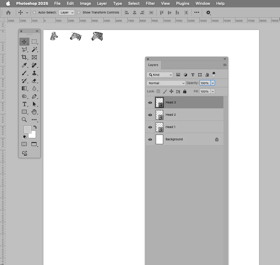

@c.pfaffenbichler @Stephen Marsh It works! Thank you SO MUCH! I had to make a few small adjustments, and added some comments for clairity - here's what I ended up with:
 * Create your base file (this script may be set to expect inchees and 300px/inch for your base file)
 * All images should be in .psd format
 * Add your images to a subfolder in the same directory as your base file
 * Enter the subfolder name from above into the var on line 27 (var subFolder)
 * The input should be a .txt file with the following format:
 *    imageName,xOffset,yOffset (each on a separate line)
 *    example: Image 1,-3,4.5

May 14, 2025 2:22 PM UTC
Hi @c.pfaffenbichler ,
Sure. Here's some sample files (all .psd). The coordinates describe the X/Y coordinates (all units in the attached file and my comments are in inches - I can change that if needed). Sample input would look like:
Head 1, X: 0, Y: 0
Head 2, X: 6, Y: 0
Head 3, X: 12, Y: 0
Head 3, X: -3, Y: 3.5
Head 1, X: 3, Y: 3.5
Head 2, X: 9, Y: 3.5
There are 23 rows, with 10/11 images per row. Even rows have 10 images and X starts at 0. Odd rows have 11 images and X starts at -3 (yes, the image will be clipped at the beginning and end of the row). If you need the full data, I can provide that as well (If the application is in .jsx, I plan on just pasting the data as an variable at the top of the file - no need to make it reusable by uploading a .csv of this data and parsing it).
c.pfaffenbichler
May 17, 2025 10:56 AM UTC
This would raise a file-selection-dialog for a txt-file along the lines of the example you posted, then place the images.
// 2025, use it at your own risk;

May 15, 2025 3:50 AM UTC
Hi @Stephen Marsh - thanks again for your example. I tried modifying it to what I think it needs, but I have no idea how to test/debug it. I added comments where I made changes or had questions. I'm going to keep looking to see if I can find any sort of VSCode extension or instructions on how to debug the code (if you have any suggestions I'd love them!). If you have any thoughts or suggestions I would also really appreciate it. I think I tried to set it up that the base document that I want the psd files to be placed on is the only document currently open when the script is run.
Stacker - Place Embedded.jsx
Stephen Marsh, v1.0
https://community.adobe.com/t5/photoshop-ecosystem-discussions/layers-creating-layers/td-p/13252109
#target photoshop
const filesToPlace = [
   { name: "Head 1", x: 0, y: 0 },
   { name: "Head 2", x: 6, y: 0 },
   { name: "Head 3", x: 12, y: 0 },
   { name: "Head 3", x: -3, y: 3.5 },
   { name: "Head 1", x: 3, y: 3.5 },
   { name: "Head 2", x: 9, y: 3.5 }
// I want the currently open document to be the base document.
// It's an empty psd doc with defined width and height in inches, with a background layer of white.
if (app.documents.length === 1) {
    (function () {
        var savedDisplayDialogs = app.displayDialogs;
        app.displayDialogs = DialogModes.NO;
        var origUnits = app.preferences.rulerUnits;
        // Changed to Inches
        app.preferences.rulerUnits = Units.INCHES;
        // I put all my source images in a folder for this to work
        var inputFolder = Folder.selectDialog('Please select the input folder:');
        if (inputFolder === null) {
            app.beep();
            return;
        var inputFiles = inputFolder.getFiles(/\.psd$/i);
        // This is duplicated from above? Necessary?
        // app.displayDialogs = DialogModes.NO;
        // var baseDoc = open(inputFiles[0]);
        var baseDoc = activeDocument;
        // Do I need to duplicate anything here?
        baseDoc.duplicate("Stacker", false);
        // Why am I closing the base document?
        baseDoc.close(SaveOptions.DONOTSAVECHANGES);
        for (let fileToPlace of filesToPlace) {
            // inputFiles has the list of all possible files (about 13)
            // filesToPlace is the array of files that I want to place with their coords (about 240 entries)
            // (Imagine 13 pics being used to create a collage)
            // As we loop through filesToPlace, we want to find the file in inputFiles that matches the name
            const file = inputFiles.find(f => f.name === fileToPlace.name);
            placeFile(new File(file), false, fileToPlace.x, fileToPlace.y);
            activeDocument.activeLayer.name = fileToPlace.name;
        // Is it necessary to remove the background layer?
        activeDocument.activeLayer = activeDocument.backgroundLayer;
        activeDocument.activeLayer.remove();
        app.beep();
        alert(inputFiles.length + ' files placed!');
        // Restore original settings
        app.displayDialogs = savedDisplayDialogs;
        app.preferences.rulerUnits = origUnits;
        // Functions
        function placeFile(null2, linked, horizontal, vertical) {
            var s2t = function (s) {
                return app.stringIDToTypeID(s);
            var AD = new ActionDescriptor();
            AD.putInteger(s2t("ID"), 1);
            AD.putPath(s2t("null"), null2);
            AD.putBoolean(s2t("linked"), linked); // false for embedded
            AD.putEnumerated(s2t("freeTransformCenterState"), s2t("quadCenterState"), s2t("QCSAverage"));
            // Is "inchesUnit" the correct unit?
            AD.putUnitDouble(s2t("horizontal"), s2t("inchesUnit"), horizontal);
            AD.putUnitDouble(s2t("vertical"), s2t("inchesUnit"), vertical);
            AD.putObject(s2t("offset"), s2t("offset"), AD);
            executeAction(s2t("placeEvent"), AD, DialogModes.NO);
} else {
    alert('Please only have the base file open before running this script...');
