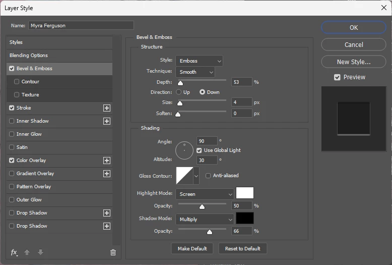

  6. Double-click on the text in the Layers panel (other than on the eyeball, the thumbnail, or the name) or go to Layer > Layer Style > Bevel & Emboss (or any of the other layer style options) to open Layer Styles (going to the menu will take you to the options for that particular layer style)
  7. Add the following Layer Styles:
    • Bevel & Emboss - click on it to open the Bevel & Emboss options to make adjustments as needed

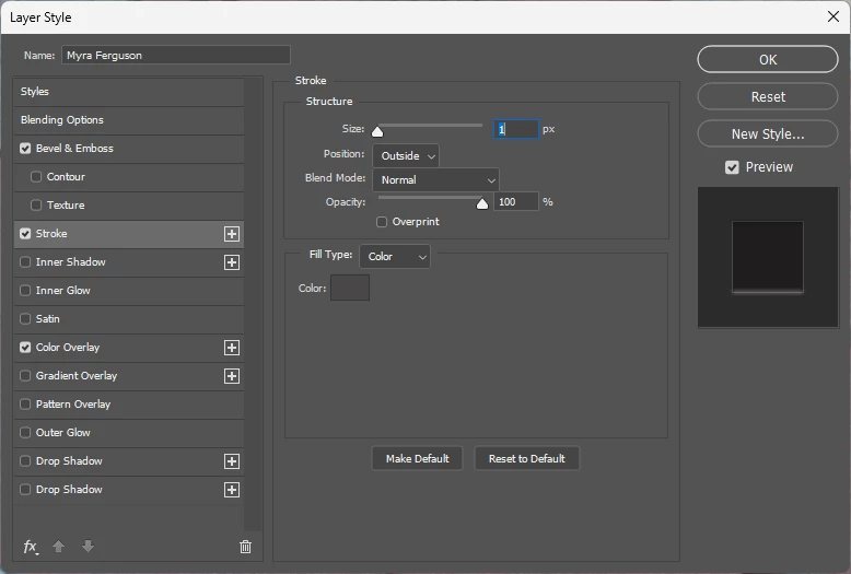

    • Add a stoke of the same color as the text if you need to make the text wider

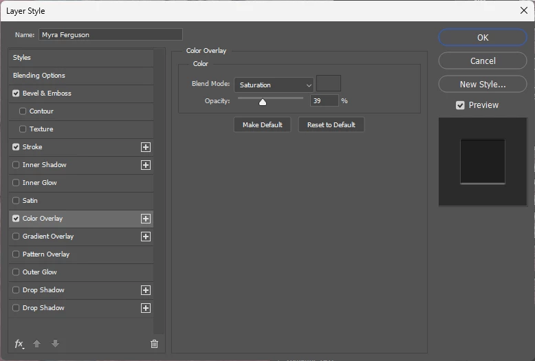

    • Add a color overlay with a Saturation blend mode to affect the appearance of the text, if needed
