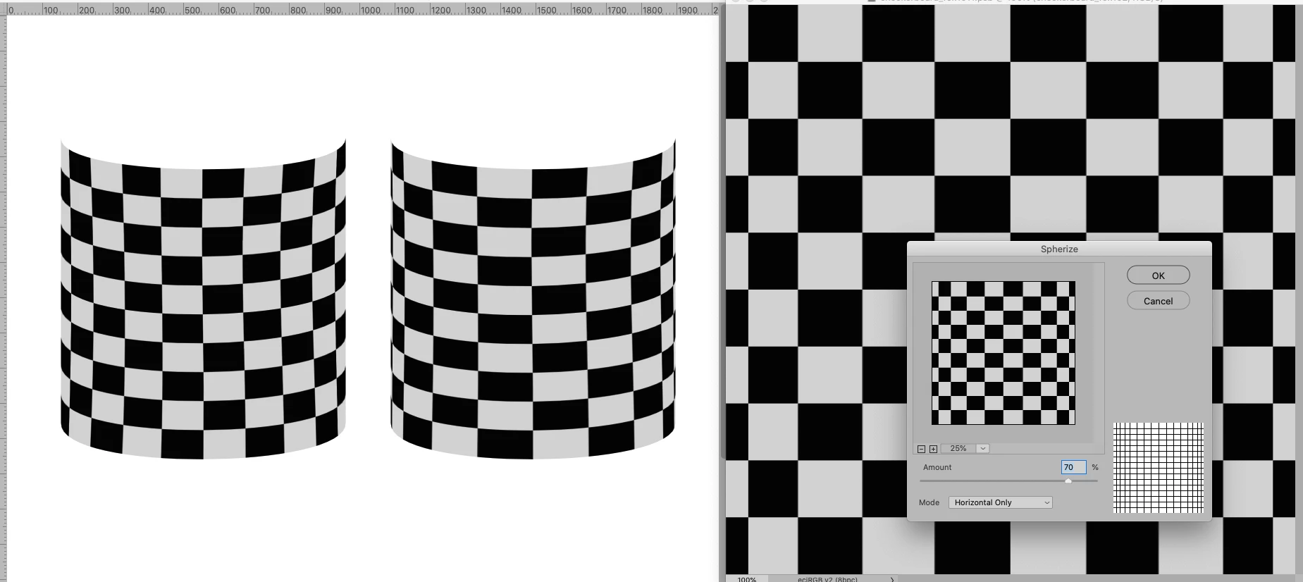

Another option might be to use a cylindrical Spherize as a Smart Filter on the Smart Object content to increase the shortening near the edges.
