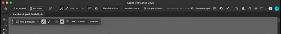

I’ve lost the "Apply" checkmark in the Photoshop options bar
I’ve lost the "Apply" checkmark in the Photoshop options bar if I use the remove tool; instead, I now have a semicolon icon.
Lost it in the PS version 27.10 and also in the Beta version 27.11
To apply a remove I have to use the contextuel taskbar.
I already reseted all tools and restarted the option bar.
Is this how the option bar should look or is it a bug in my versions?
Would apreciate some help with this

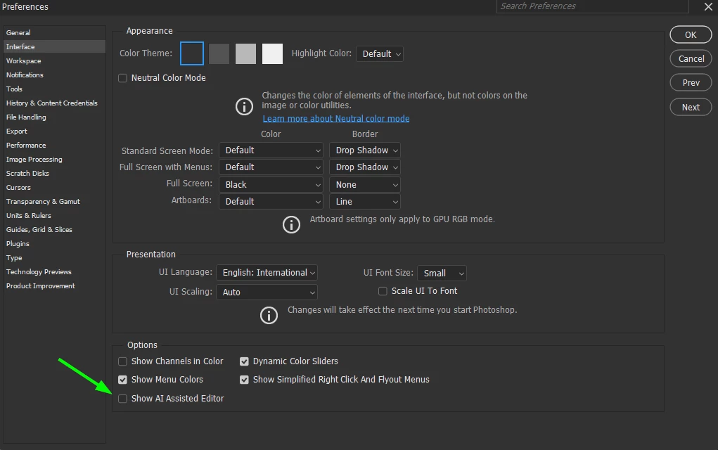

    ​@rs68255699 try disabling this option in the preferences to see if it helps

    Got my crop tool back to normal and got rid of the AI assisted editor. Thanks for all your help.
    Sep 30, 2026 3:18 PM UTC
    Thanks, that worked! Happy to get rid of AI too.

    There is another possible solution that you should keep in mind as Photoshop becomes more complex. Adobe added another way to apply pending changes, another form of the checkmark. It is a button in the relatively new Contextual Task Bar that you should look for. The name depends on what you’re doing. For example, if a transformation is pending the button says Done, if a selection is active the button says Deselect, and if a Remove tool stroke exists it says Remove.
    In the demo below where a Remove tool stroke is pending, in the Contextual Task Bar you can see that the tool tip for Remove button is exactly the same as the tool tip for the checkmark: Apply to Current Strokes. That means, if you can’t see the checkmark because the options bar is not wide enough, you can still apply the change by clicking that Remove button.
    So while in the past you had at least two ways to confirm a pending action, now you have at least three (the last one is the newest):
    • Click the check mark in the options bar
    • Press the Enter or Return key
    • Click the (apply) button in the Contextual Task Bar
    So if you can’t see the check mark, you don’t really need it…because there may be at least two other ways to commit the pending action.
    Also note that the “semicolon” button you noticed is a symptom of the options bar getting cut off at the right side, because it isn’t a semicolon; it’s a partially visible Provide Feedback button.

    Ged_Traynor
    Ged_TraynorCommunity ExpertCorrect answer
    Sep 15, 2026 6:52 AM UTC
    rs68255699
    Sep 15, 2026 7:27 AM UTC
    Yeah….. That’s it! Solved! Thank you so much.
    I had never thought of this change.
