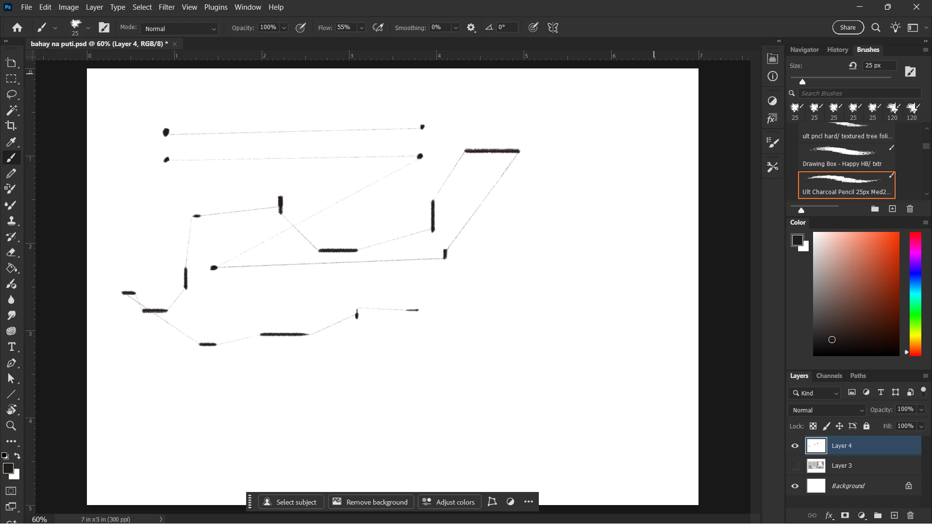

I want to draw straight line using brush tool in all angles, but it fades
I'm using a Huion tablet. Whenever I draw straight lines using shift at different angles, they fade. The size and opacity of my beginning anchor point aren't the same as the line I created. It works fine on vertical and horizontal lines. So how do I fix this?

Hello, @Sameer K. I am using a Huion Inspiroy 1060p. I have done the reset tool, but it didn't work.  Though I have found a different way but it's not satisfactory. When I increase my brush size compared to the size that I want and just lightly damp my stylus, it gives me my desired stroke. It also normally works specifically on hard and soft round brushes, and when I'm using a mouse (applies to all brushes).
