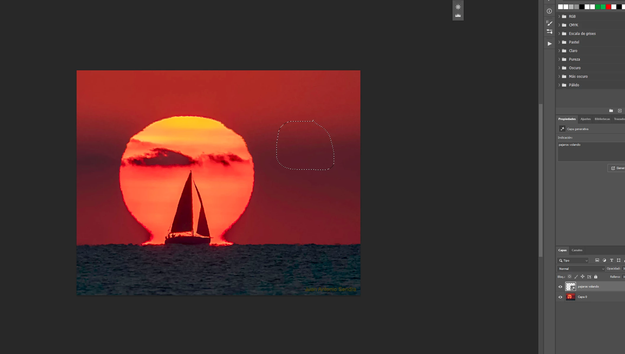

Buenas desde hace semanas que mi IA de photoshop no funciona le digo que me genere algo, carga la barra hasta la mitad y me genera una capa pero no generó nada.
Mi conexión es estable, no sé que puede ser! En la version beta tampoco me funciona.
Os dejo una imagen.

Hey, @Nikola33006411os49. Welcome to the Photoshop Community. I reviewed the account you used to log in, and I found an active Team/enterprise subscription.
Is this a personal machine, or does an IT team manage the device? If yes, ensure all the Adobe Network endpoints are whitelisted: https://adobe.ly/4iKsXwk
You can try using Photoshop Web (https://adobe.ly/3WkhVFm) on an alternate device & internet network to rule out it is a network issue.

Its done, It was the firewall, thanks
