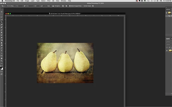

After update to PS CC 2018 (mac, running v. 19.1.3), the frame around my images doesn't resize after cropping, rotating or resizing. It remains static.
Before:

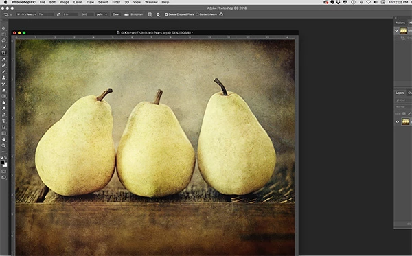

After crop:

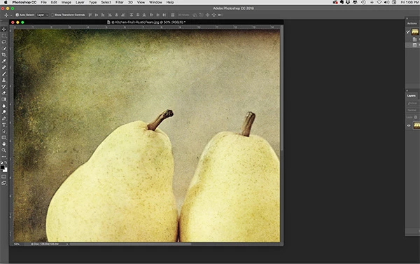

The frame around the image *used* to resize with it. Now it stays static. If I rotate, it stays the same also, and if I upsize, it stays small and only shows part of the image:
So - essentially - the image frame stays the same size as the original image. CMD+ resizes it, but I didn't have to take that step before.
