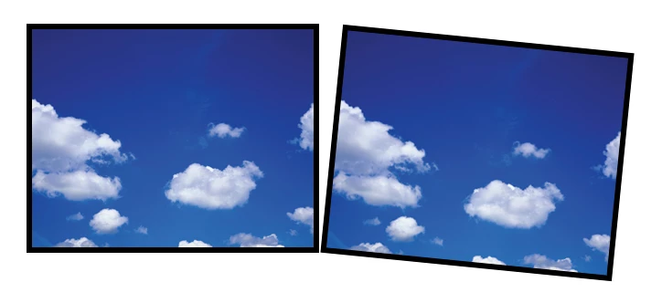

I've never had this problem before. I'm running CS5 Extended 64-bit. Here is my problem:
I have an image with text on it. When I open the image, everything looks fine. But if I rotate it with the tranform tool, the image then becomes noticably pixelated. This has never happened before... or at least I don't think it has. It's really distracting and looks horrible. Could someone please help me out? What's going on and how do I fix it? I just opened up Photoshop tonight and it started happening. Below is an example of what's happening.
The original image:
After rotating with Tranform tool:
Notice how the edges are not as smooth as the original. The same thing happens when I try to re-scale the image... what's going on!!?

    I've got the resampling algorithm set to Bicubic... shouldn't that keep the lines and edges smooth? The problem only happens when I rotate or resize an image via transformation. Resizing with Image Size is no problem.
    It's really an issue with rotating. If I try to rotate an image, the edges become jagged.

    The original image is already pretty pixelated.
    What resampling algorithm do you have set in preferences?  That looks like you have nearest neighbor or bilinear interpolation chosen.
    Nov 13, 2010 2:33 AM UTC
    I just tried drawing a diagonal line with the line tool as well as rotating original, unrasterized text. It seems like anything on an angle gets pixilated.
    Also, can you explain what you mean by "resampling algorithm?" Thanks for the reply!
    Edit: This might give you a better idea of what I mean. The original is on the left and the rotated is on the right. Notice how the edges are no longer smooth.
