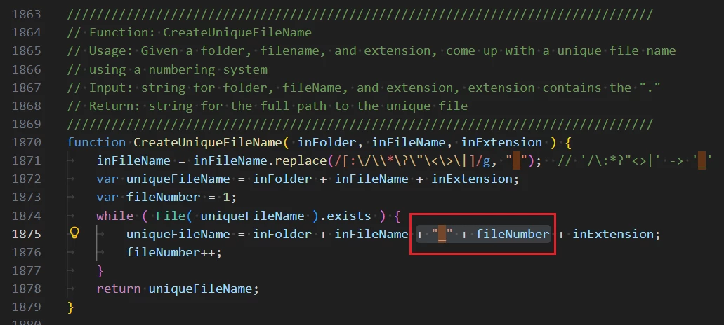

You can save without creating sub-folders by using the "select folder" option with "keep folder structure" and selecting the parent/root top-level directory, however, originals will not be overwritten, a "_1" suffix will be added. The script would require modification to work differently.

The Image Processor version that ships with Photoshop 2026 is "1.2.0.3", it would surprise me if Adobe has made any changes to this script in years.
So perhaps it never did overwrite?
As I previously mentioned, the code would need to be edited to do so, such as removing the following highlighted entry (untested):
