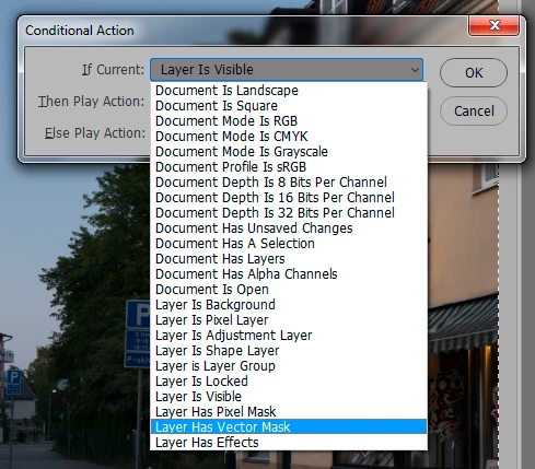

As for the second part - you can "Insert Conditional" steps from the flyout menu in the Actions panel. These are the options:
You can then have a secondary action that will run if that condition is met. This would be recorded separately and called from the above dialog.
