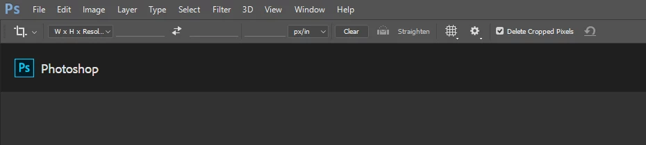

Correct answer airbrushfx
Reset the tool. Select the tool from the toolbar. After that, go up to the crop icon top left and left click to get the dropdown menu and click reset tool. Problem solved

I seem to remember the fix was to reset the tool. For me R click the tool
when it appears on top left. But why it happens is still a mystery for me
Regards, M Munier

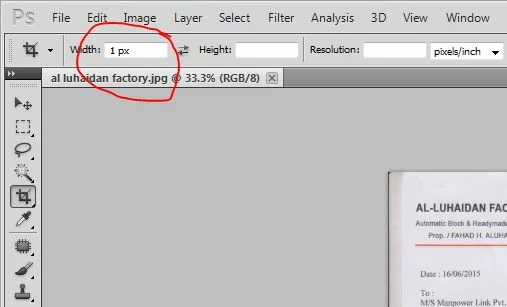

I Was stuck with the same problem with a long time but suddenly I noticed that there was a 1px in width as in picture below as i select the crop option. Please remove that and try it.
Thanks me Later.
October 24, 2016
Had this trouble in CS3 - clearing the 1px from the field worked.  Thanks!

I've got exactly the same issue - images disappearing when I crop. It was previously working fine, all of a sudden..'poof' gone! I've not changed any settings and I don't have the technical expertise to really follow what you guys are discussing. Help!
....and a few minutes later - fixed! It was the old set to '1' in the width bar.
