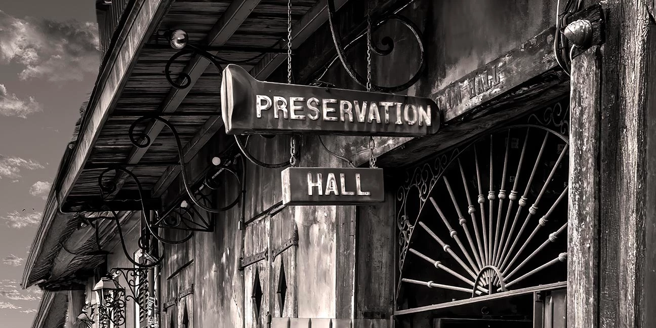

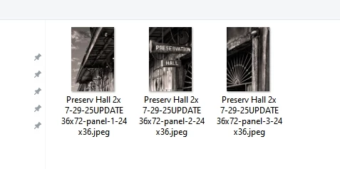

Thanks to everyone here who tackled this question. Yes, it is for canvas printing of a 36x72 inch photo divided into three 24x36 inch panels in order to save lots on printing and shipping. I actually spent the weekend rolling through everyone's post and I am saving the thread for future reference. I run a small photo sales business through the ETSY platform after 20 years in commercial & wedding photography. I have been an avid Photoshop user for many years but never needed to do any tiling or dividing of an image. Through testing various suggestions from all of you, I made it work! THANK YOU! Original 36x72 and resulting 3 panels are attached.
