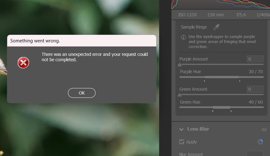

In Camera Raw Filter tool, Lens Blur is not getting activated while processing image and the error message is "
Lens Blur option if Camera Raw filter is not working,  showing an error "Something is wrong.....etc" without any error code.

    Hi @PrasantaGhosh, thanks for reaching out! Lens Blur in Camera Raw is an AI-powered feature that requires GPU acceleration. Let's try a few things to get it working:
    1. Update Camera Raw: Make sure you're on the latest version.
    2. Update your graphics driver: Download the latest directly from NVIDIA, AMD, or Intel (not via Windows Update).
    3. Check Camera Raw GPU settings: Open Camera Raw → Preferences → Performance and confirm your GPU is detected and acceleration is enabled.
    4. If you're on a laptop, make sure Photoshop is set to use the dedicated GPU: right-click desktop → Display Settings → Graphics → set Photoshop to "High Performance."
    If none of these steps work for you, we can continue to troubleshoot the issue. I hope this helps! ^CH

    I did all processes you havesibi mentioned and checked all the possible sources of this error, still it is not working. Version details is given below for your reference:

    Thank you. Your solution is applied and the error is fixed.
