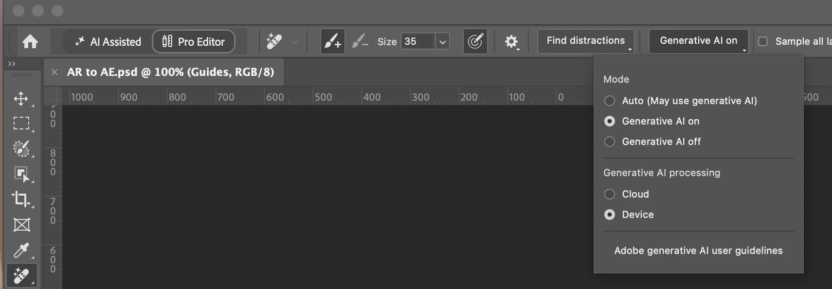

    Please also go to Photoshop > Settings > Image Processing > Remove Tool Processing > Faster. Select the Remove Tool from the Tool panel, then go to the Option Bar > Generative AI on > Generative AI Processing: Device, and test the same removal.
