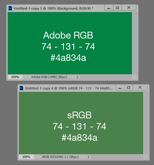

    RGB/Hex numbers are color space specific. Different color spaces will yield different colors from the same numbers.
    Is there an embedded document color profile, and which one is it?
    Note the numbers here:
