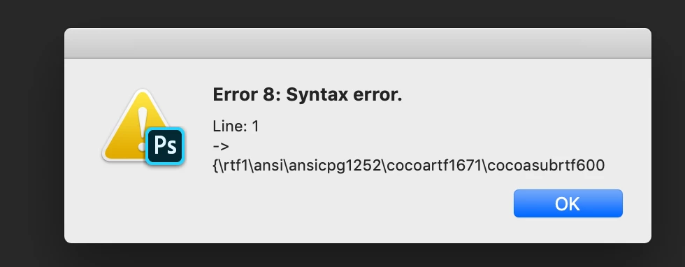

Hello, i think i run into similar issue.
My file is originally 300MB, but it just includes 3 very tiny artboards for web banner which within 300x350px. Every artboard has only 1 layer with no special effect. Items in the artboards are copied and pasteed from another file. I suspect something wrong so i delete all the layers and remain 1 empty layer in one artboard. the file is still at 280MB??!?!
I tried your method but there is an error while running the jsx file
i am not sure which part went wrong...
Stephen Marsh
February 12, 2021
You incorrectly saved the file as a RTF rich text file, not as plain text file.
