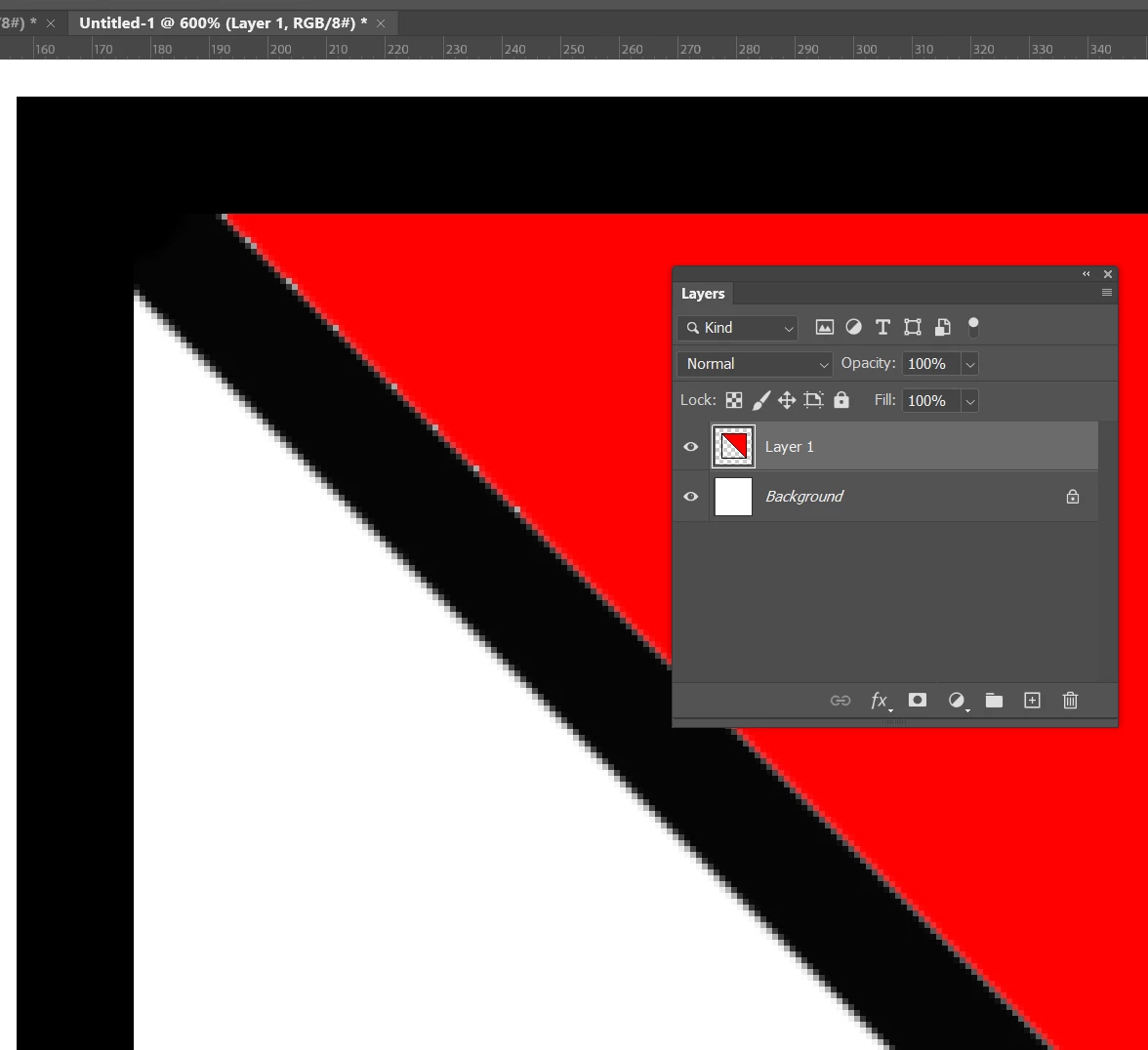

Try this:
I have a square with a diagonal splitting it into two triangles.
I have used the paint bucket on the upper triangle aplied to the same layer (Layer 1)
Zoom is set to 600% making the unfilled pixels stand out.

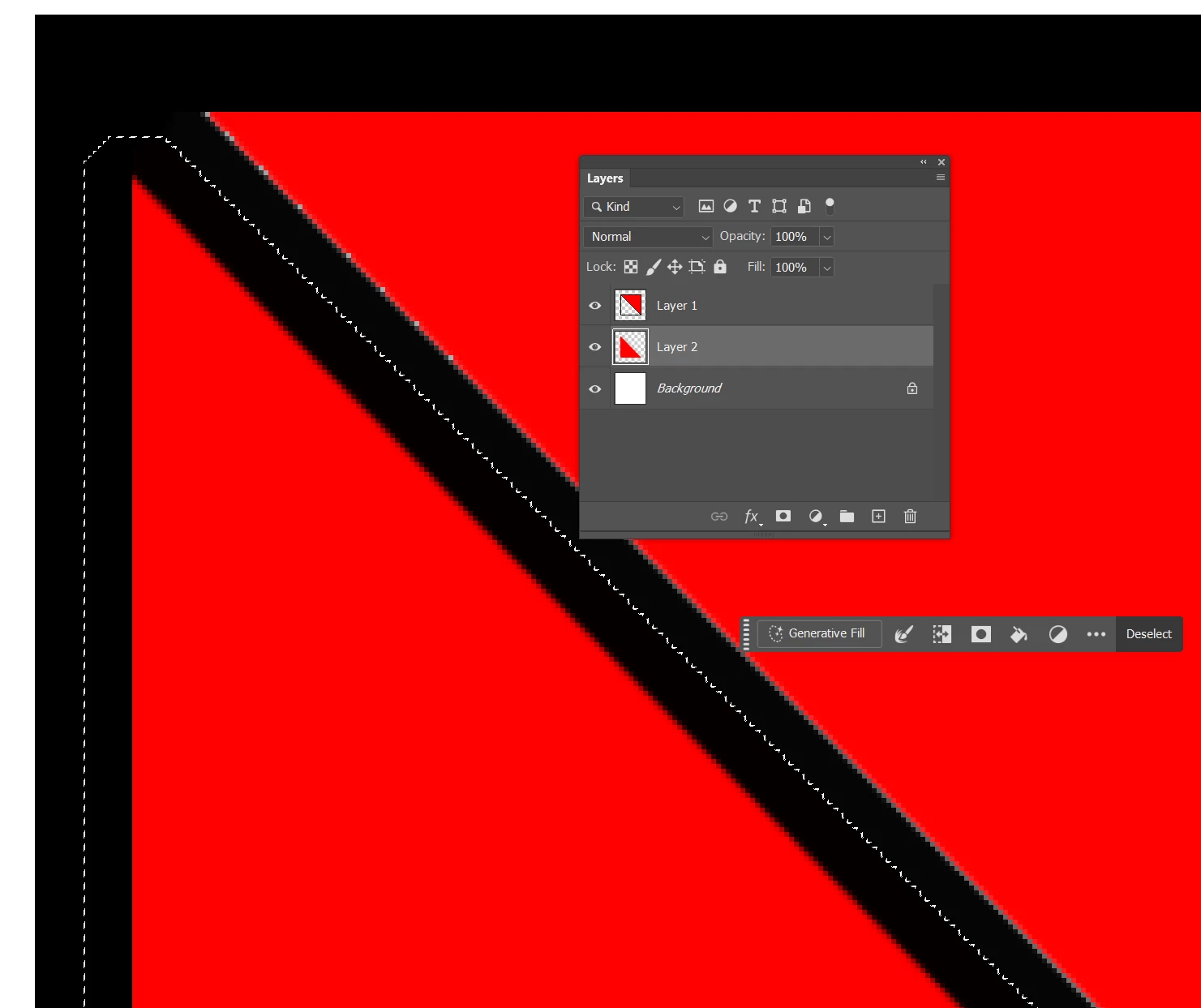

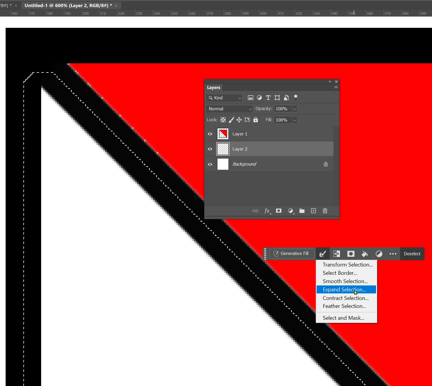

I have used the magic wand to select the lower triangle, and using the Contextual Task Bar I have expanded the selection by 10 pixels.
I can now fill that selection in a new layer below the black outline, because it overlaps, it will completely fill the black triangle.

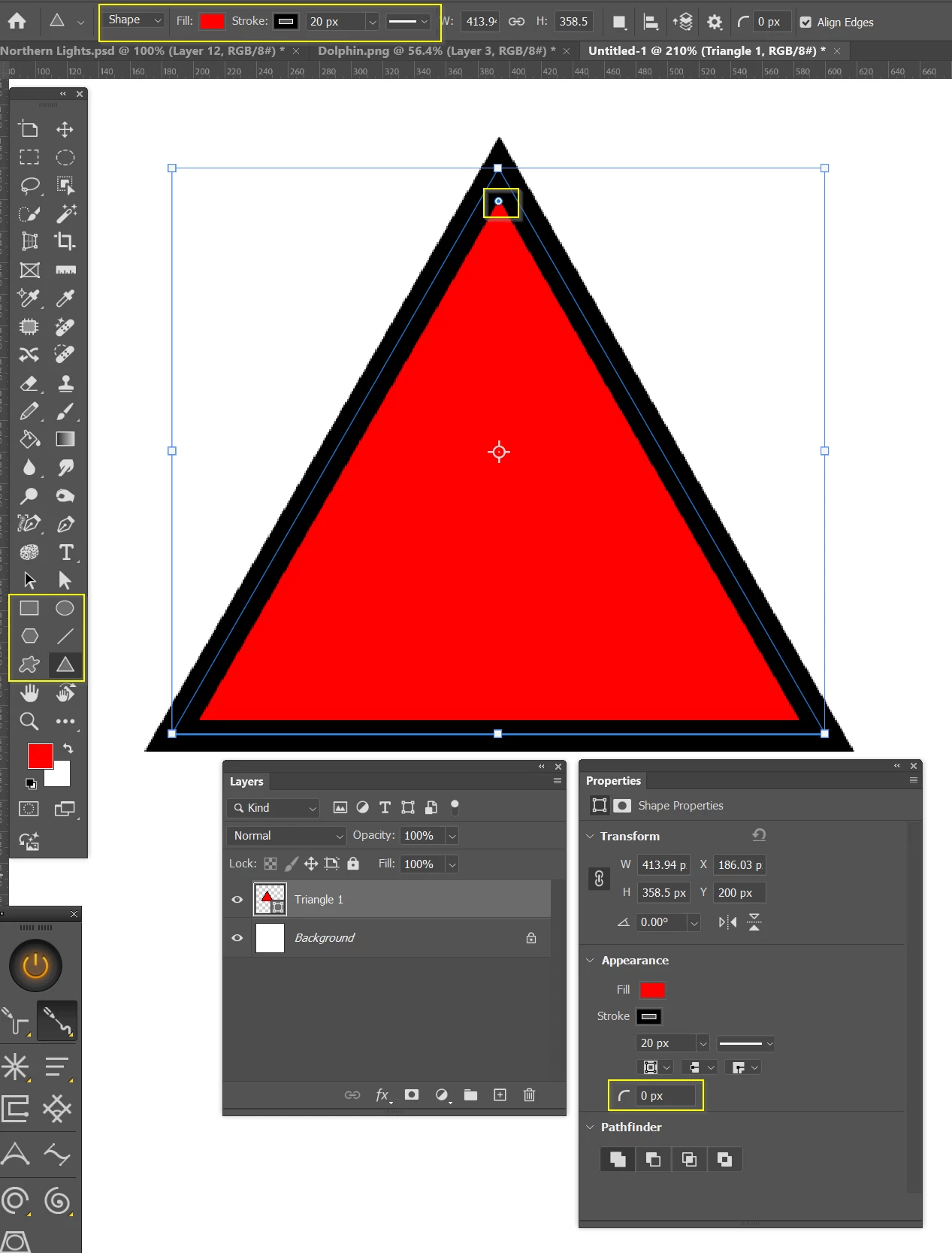

When possible, we'd use a vector Shape layer and use a Stroke for the outline.  You can even radius the corners by either dragging the handle (my yellow highlight at the top of the triangle) or by using the Properties panel (bottom right).
