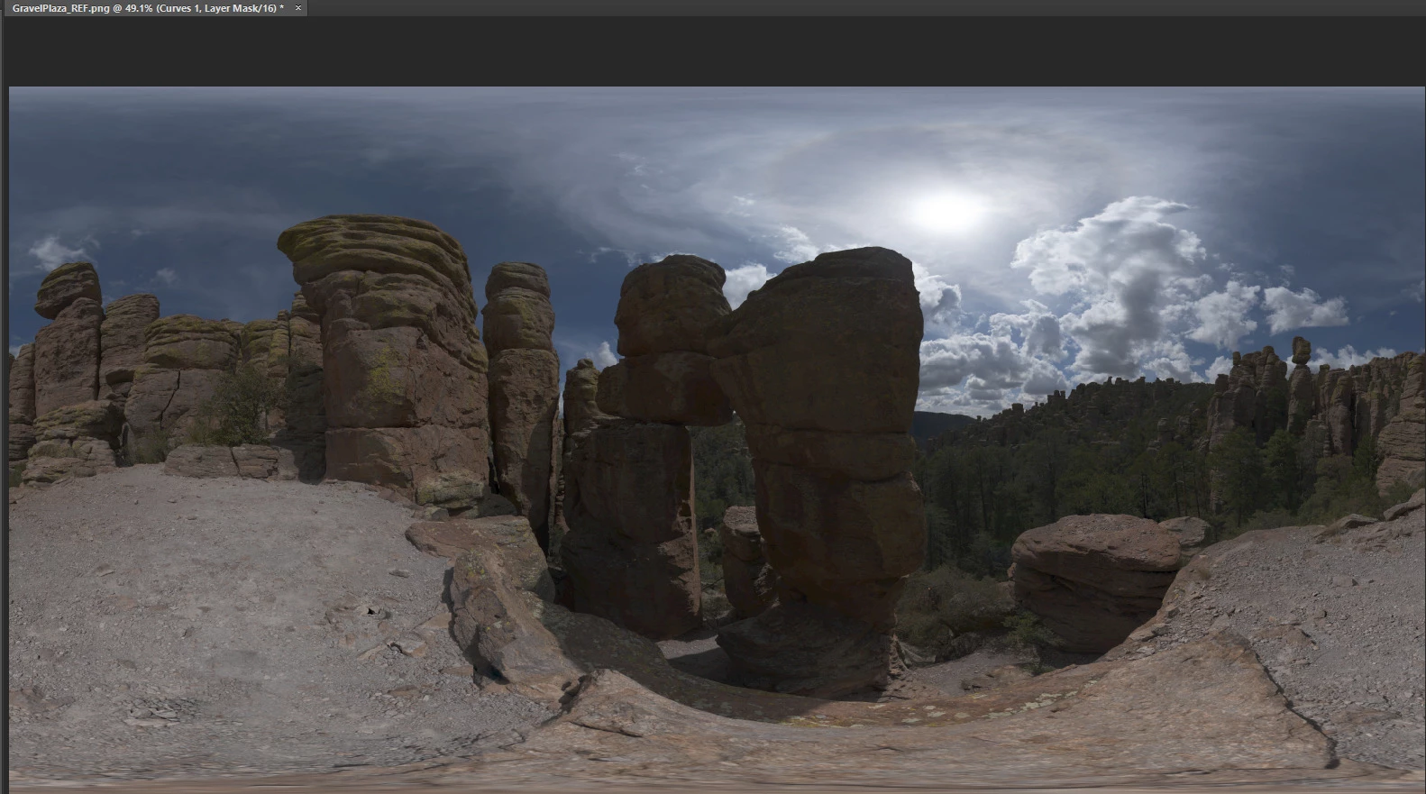

Here you go.
Here is the original 16bit full range 0-65535 HDR image. The centre of the sun is around 63455, and the darkest shadow around 50.
To test if Photoshop destroys data, I adjusted the gamma of the image in PhotoLine.
I then flattened this image and saved it as a new full range 16bit PNG file.

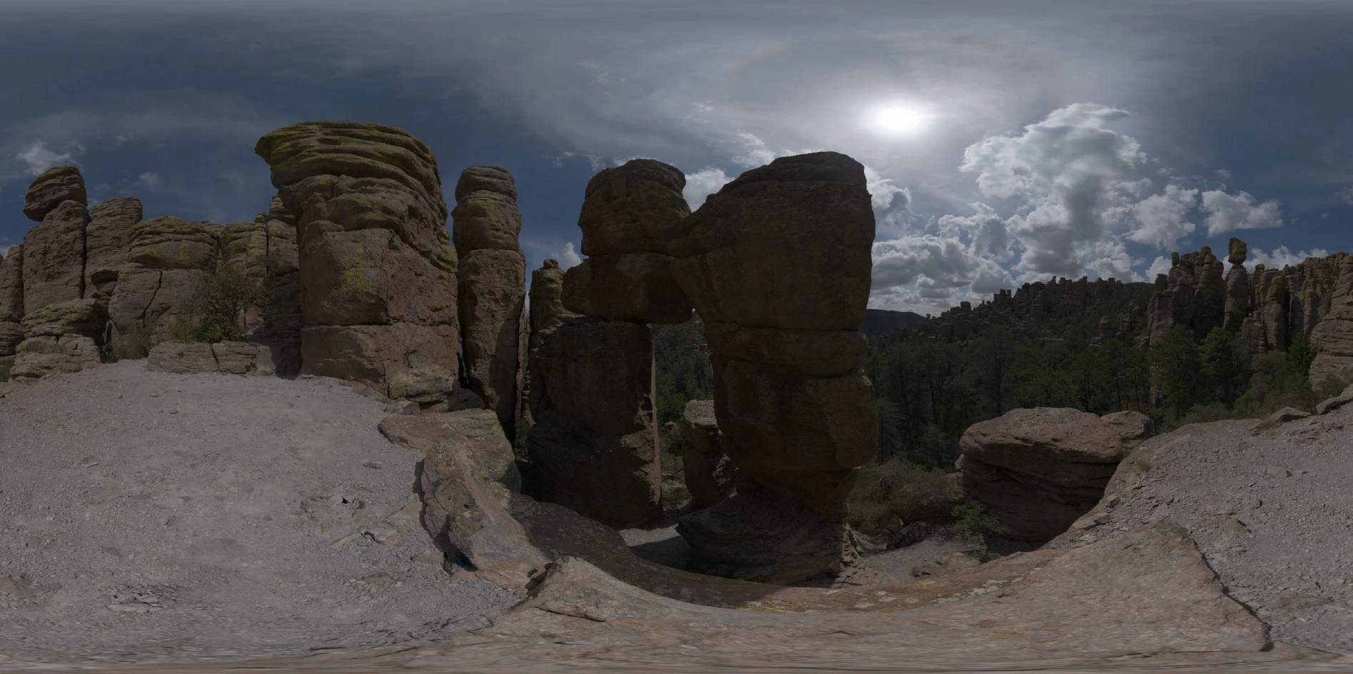

In PhotoLine I reversed the gamma again:

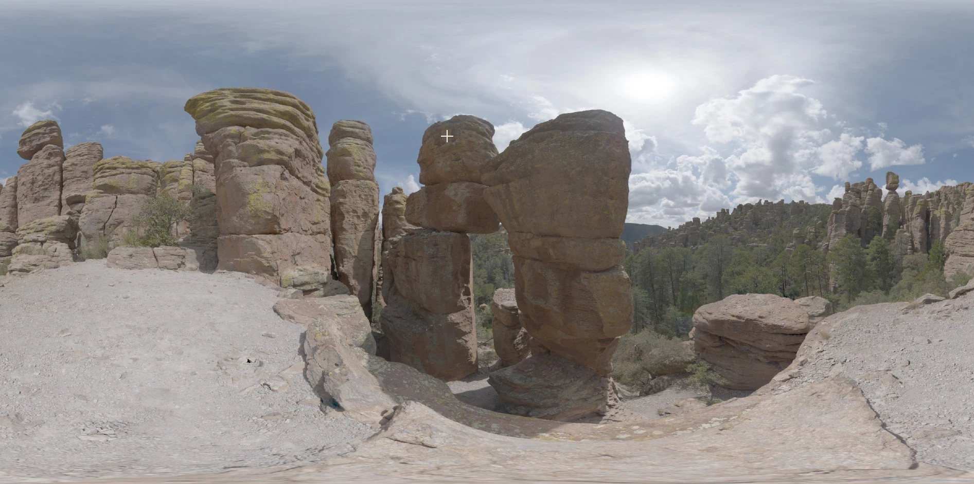

In Photoshop I opened the same image, and reversed the gamma once more:
Result: in PhotoLine the sun's data remains unchanged. In Photoshop it blows out. The highest value possible is 32678, and indeed the center of the sun is exactly that value. But it also lost details, and the halo is gone. Photoshop's conversion to 0-32768 from a higher range of 0-65335 values seems to ignore the higher dynamic range values and maps the colour range in such a way that the higher range is capped.
Which means Photoshop destroyed the high-range values, and the result is very visible.
Is that enough proof for you?

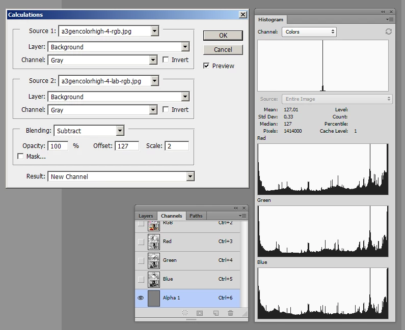

Dear Christian, dear Dag,
practically working in Lab in 8bit (Lab-8) seems to be not so bad:
The first edition of Dan Margulis book "Photoshop LAB Color" is entirely based
on PSD Lab-8 data, at least this is my impression after checking some examples
on the CD.
My test:
The first image IM1 is an sRGB image of a PDF page (a rather complex printer test
page) with 288ppi, then downsampled for 72ppi, then saved as JPEG (Q=9).
The second image Im2 is an sRGB image of the same PDF page with 288ppi,
then converted to Lab and saved, then reloaded, converted to sRGB, then
downsampled for 72 ppi, then saved as JPEG (Q=9).
The third image, if shown (it is in background), is the result of the calculation for
Im3 = 127 + 2*(Im1-Im2) for the gray channel (numbers 0..255), actually a uniform
area, but the histogram has a small peak with standard deviation 0.33.
Perhaps is my test too weak or even wrong? Then we have still Dan Margulis' book...
These arguments are in my opinion saying, that it is not generally wrong to work
in Lab-8.
Best regards --Gernot Hoffmann
