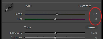

    The concept of color temperature, measured in degrees Kelvin, doesn't apply for RGB files. You'll notice even in Lightroom, when working on an RGB file, that the scale changes into a numerical one centered on 0.

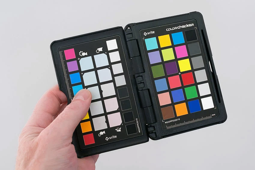

    What you can do in RGB is to neutralize so that R=G=B. There are eyedropper tools in the Levels and Curves dialogs to do that. If you really want to get a neutral gray along the whole tone curve, you can include a colorchecker in a test shot (or along the edge and crop it out later):
