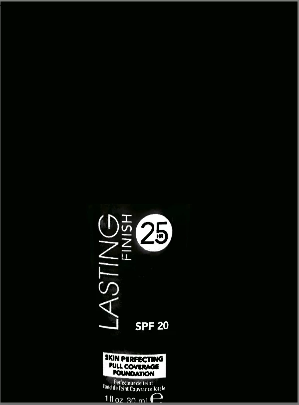

Hi
You could try this
To select the red : Make a copy of the blue channel, invert it and  use a curves adjustment to increase contrast, finally brush with a black/white brush at 50% opacity and set to overlay blending mode to sharpen the edges. Paint over the unwanted red selection from the bottle top with black. Make a selection from the channel
For the White :
Make a copy of the green channel and do the same steps as above (apart from inverting it).
Dave

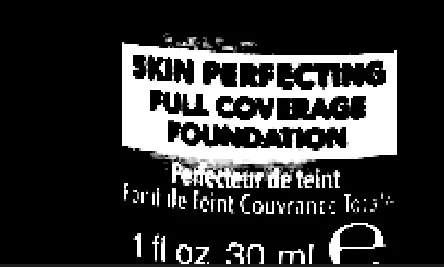

ParanoicAuthor
April 13, 2018
Thanks man :-)
Especially for you advice. Even though I must say it si a little bit hard to do the contrast of that small text below the white rectangle as nice as you did it.
This is my result so far:
davescm
davescmCommunity ExpertCorrect answer
April 12, 2018
Hi
You could try this
For the White :
Dave

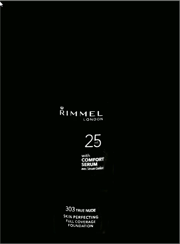

Norman Sanders
April 12, 2018
To get the red portion of the label (ignoring the white for the moment) convert the Mode to Lab Color and distort the  a  channel as shown to separate the red from the tan. The increased red saturation made the next step, Select > Color Range, more efficient in separating the red from the background. No concern for the type in the red panel a the bottom. It could be a solid panel with a type dropout.
The white type: Lab Color. Zero the  a  and  b channels to create gray, then use the L channel to produce the left image. Move into RGB. Curves to darken the area surrounding the type. I overdid that step and sacrificed the clarity.  The RGB step should be redone,
