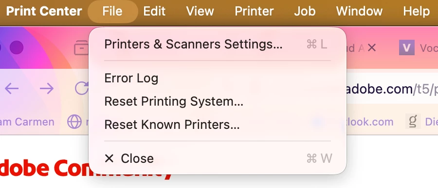

Exercise all four of the options in this Print Center submenu and report on the results --

What are your symptoms, Tomas -- any error message? So, you hit Print, thinking everything's ok -- but no printout?
Any error conditions like Out Of Paper from the printer? Depending on the brand of printer, you might find hints in Print Center>File>Error Log.
