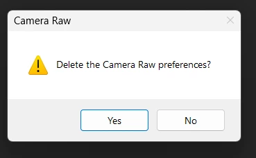

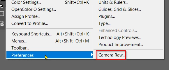

    OK, I’ve got it to work.
    Inside Photoshop go Edit > Preferences > Camera RAW click and immediately hold down the Alt key (Ctrl on a Mac).  That brought up the reset dialog for me.
    Good luck and let us know if that worked.

    Trevor.Dennis
    Apr 21, 2026 1:25 AM UTC
    Opps, you are right Jane. It is the Opt key.  I still had a job getting it to work with Windows, and I was trying a bunch of different ways.

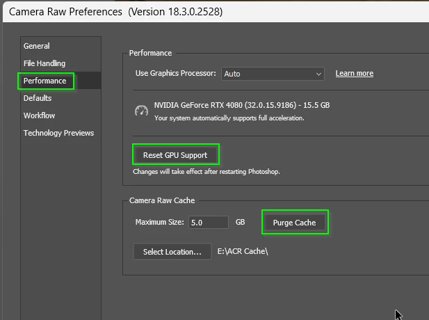

    Trevor.Dennis
    Apr 20, 2026 10:46 PM UTC
    Reset GPU Support and Purge Cache
    We should be able to reset Camera RAW Preferences by holding down Ctrl Alt Shift immediately after opening a RAW file, but I can’t get that to work.  I’ll see if I can find a manual method.
