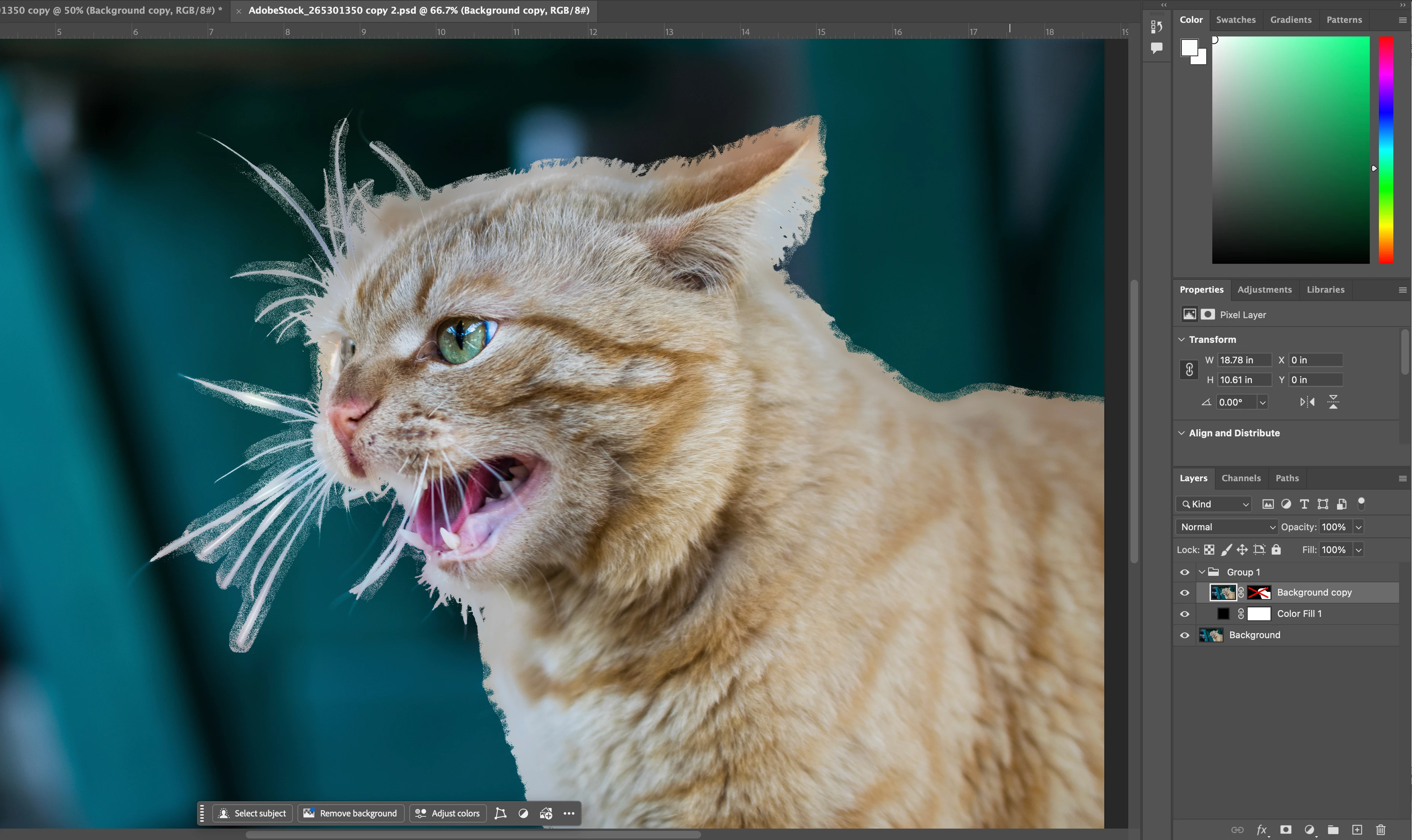

Hi guys,
Every time I use select and mask to refine my selection and output it as a new layer with mask, then disable the mask to look at the before, I get a bunch of artifacts on my image. Refining the mask using a brush with white or black doesn't work either. I'm attaching a picture for you to see.866378iAA78EB536D5E5631.jpgI'm on a MacBook Pro with an M2 Max chip and 96 GB memory.

@JulianaSwenson Uncheck 'Decontaminate colours' in Select and Mask. There are better ways to achieve decontamination, such as adding a new layer clipped to the masked layer, setting the new layer to color blend mode, and painting on it with a brush picking up colours around the edge as you paint. This puts decontamination on a completely separate layer and gives better control over the process.

Nov 27, 2025 6:55 PM UTC
Hi Dave,
Thank you for your reply. I noticed the decontamination problem after I made this post and watched a video on YouTube about doing what you said and it worked!
Best,
Juliana

Nov 27, 2025 6:52 PM UTC
Hi Srishti,
Thank you for your interest in helping me. I’m using version 27.1.0 of Photoshop. This issue happens with every image when I click decontaminate colors in the properties panel of Select and Mask. The same thing happens when I click on Layer-Matting-Color Decontaminate. If I don’t try to decontaminate, these issues don’t occur.
Best,
Juliana
Nov 27, 2025 6:54 PM UTC
Hi Srishti,
