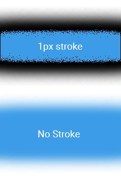

I can't seem to figure out why I'm getting this jagged edge on certain layer styles. The one shown below is a 1px inside stroke. I've disabled usage of the graphics processor, no luck there. I've checked resolution & bits per channel. Couldn't see any obvious anti-aliasing issues... So I'm not sure where to go now. Any ideas as to what I'm missing here? Thanks!

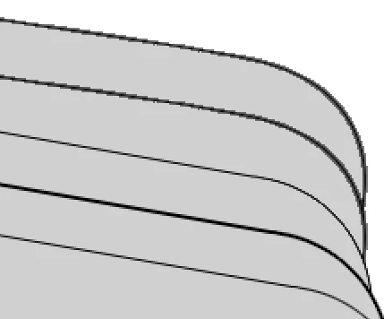

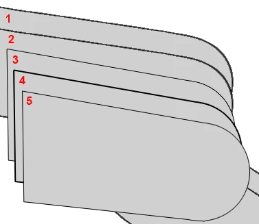

  1. The original as opened from Dropbox
  2. I cleared the style and added it again with the same settings, and got the same result.

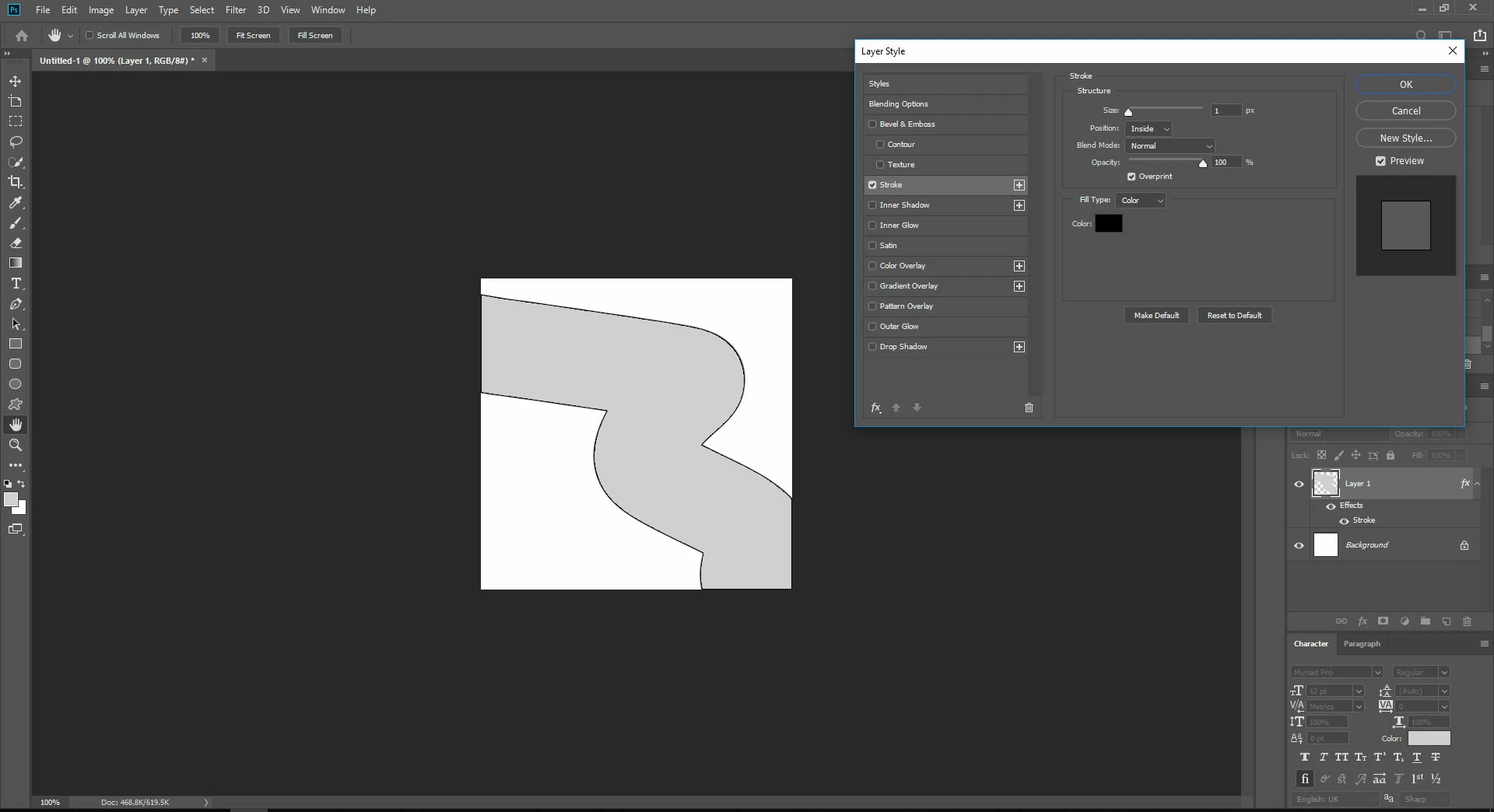

  3. Here's  where  it gets interesting.  I created a similar raster shape with the same angle and curve,  and  added the same layer style stroke, and it is much thinner than the original.  Note this is a simple raster object  made by filling a selection.  There is no feather set in the Options Bar.
  4. Same again, but using a two pixel stroke to see if  matched the original.  The original is definitely set to 1 pixel stroke.
  5. I Ctrl clicked  the layer to  load the selection, and  used  Edit > Stroke and applied a 1 pixel stroke.
A  section at 200% zoom.  This shows  the  original shape/layer  (which was raster as DL'd from Dropbox) appears to have no aa,  and the  same thing happened when I applied a LS stroke to a copy of the same layer.  I was wondering if something like the Preferences FT algorithm might make difference. I usually  have it set  to bilinear but I changed it to bicubic smoother to give it the best chance.  I think  that was grasping at straws, and made no difference.
My similarly shaped layer clearly has more effective aa,  but I have no theory as to what is going on here.
[EDIT] Just a thought, but I  was wondering if it was  a display issue, and I even considered saving to JPG and opening in  another app, but I think my experiment above shows that not to be the case.   There is definitely something going on with the way Photoshop is laying  down pixels.

Very interesting! Yeah it seems when the edge is harder (i.e. shape layer) the issue does indeed disappear. Though when used on a brush stroke (even set at 100% hardness) the issue is pretty bad and get progressively worse the softer the brush is. I'm relatively sure that strokes on soft edges used to fade appropriately in earlier versions of Photoshop rather than artifact like this. Though I can't say with absolute certainty!
