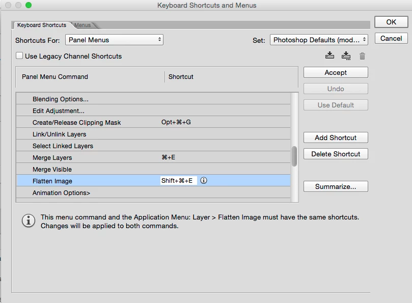

    Here is a protocol that should work for anyone experiencing the warning alerts and/or keystrokes not functioning properly.  You will want to refer to a master list of Photoshop's default keyboard shortcuts. The list is here from Adobe's website: Default keyboard shortcuts
    Your next step is to open Photoshop, and under Edit in the menu, scroll down and select Keyboard Shortcuts.  A dialogue box will come up with a few tabs, each containing many options. (That master list linked above will come in really handy at this point.)
    As you look through the Keyboard Shortcut dialogue boxes, you will notice that some of the combinations are either a) different than previous releases, or b) not there at all.  Go ahead and adjust them to your liking, just highlight the area you'd like to redefine, then hit OK.  Like this:
    I just did a fresh install of Adobe CC the other day, and everything was a bit haywire RE: keystrokes not working and also giving the warning alert sound. This has essentially fixed the problem. I will add to this post if additional workarounds are needed.
