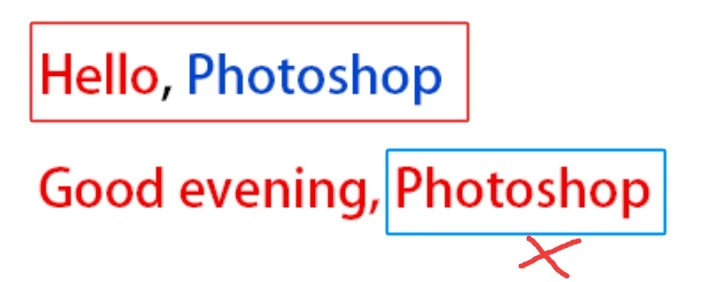

Keyword replacement issue
I want to replace 'Hello' with 'Good evening', but the color will be completely changed. How can I keep the original color?
var layer = app.activeDocument.activeLayer;
if (layer.kind == LayerKind.TEXT) {
    layer.textItem.contents = layer.textItem.contents.replace("Hello", "Good evening");

Thank you for providing the code. I'm familiar with the built-in replacement feature in Photoshop. However, it has significant drawbacks—it's very slow and can cause errors if fonts are missing, leading to an abrupt stop. So, this is not what I'm looking for. I really appreciate your help.
c.pfaffenbichler
Dec 5, 2025 3:25 PM UTC
As @Stephen Marsh indicated editing a Type Layer with DOM code cannot preserve varied formating (including colors), so you can either use AM code or try UXP code.
