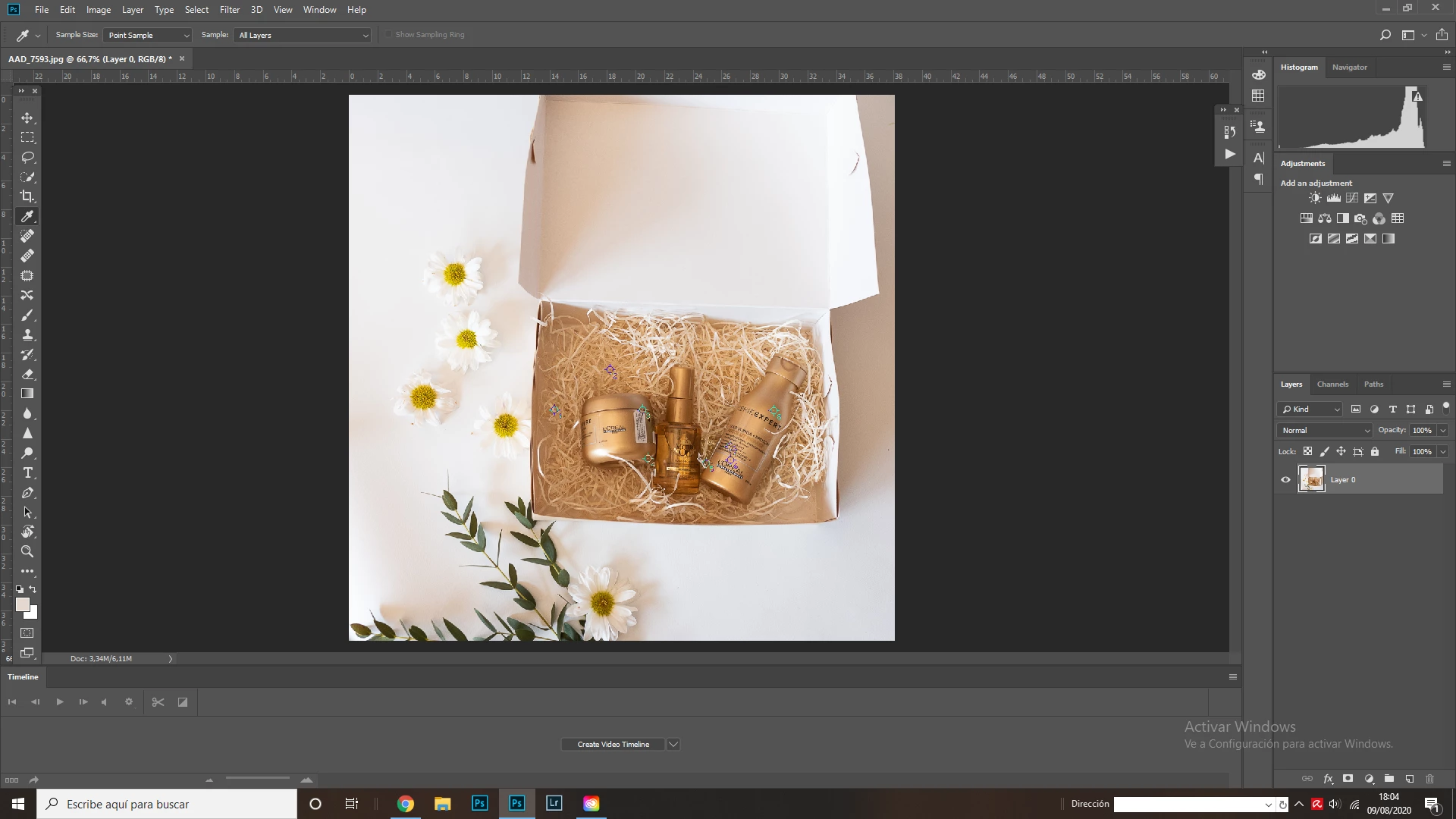

la linea de tiempo no se activa
Buenas tardes ! ojalá puedan ayudarme,no puedo hacer que la linea de tiempo en mi photoshop se active,o sea ,la selecciono desde la ventana y se me abre debajo como debe ser ,pero esta inactiva,alguien podrá decirme como lo soluciono por favor ?

Hi @Fuerza_Milagro7039,
Thanks for reaching out, and I completely understand how confusing it can be when the Timeline or animation playback doesn’t respond as expected. Based on what you’ve described, it sounds like you’re trying to create a frame animation in Photoshop but can’t get the “Create Frame Animation” option to activate.
Here’s a quick walkthrough that should help.
 • Go to Window menu > Workspace > Motion to make sure the Timeline panel is visible.
 • In the middle of the panel, you’ll see a dropdown. If it says “Create Video Timeline”, click the small arrow beside it and choose “Create Frame Animation” instead.’
 • Now click again on the “Create Frame Animation” button. This step is key, as it activates the first frame.
 • Once the first frame appears, open the Timeline menu (the three- or four-line icon in the upper-right corner of the Timeline panel).
 • From that menu, select “Make Frames from Layers.” This will automatically generate frames from each visible layer in your document.
 • You can then adjust timing, looping, and frame order before pressing Play (or the spacebar) to preview the animation.
If the Timeline still doesn’t behave correctly after following these steps, please share a screen recording of your workflow so we can better understand the issue.
Please try this workflow and let us know if it resolves the issue.

Sep 20, 2025 6:32 PM UTC
Encontré solución a este problema colocándome en el frame 1, dándole click para reproducir todos los frames, volví al frame 1 haciendo alguna mínima modificación y el problema se solucionó. Espero sirva para futuras preguntas.
Sep 21, 2022 10:39 AM UTC
Aunque veo que la pregunta es de hace dos años, y supongo que ya tendrás resuelto el problema, por si a alguien le sirve, después de volverme loca porque me sucedía como a ti, trasteando di doble clip en la opción "crear animación de cuadros" y se activó todo. No basta con señalarla, tienes que dar doble clip y te aparece la primera capa, pinchas en el icono desplegable de la derecha, (el de las 4 líneas paralelas) y  al deplegarse le das a la opción "crear cuadros a partir de capas". Posteriormente sólo tienes que ir añadiendo el restp de capas.
Oct 30, 2022 6:09 PM UTC
Me salvaste! muchas graciassss! estaba al borde de la desesperacion buscando por todos lados.. gracias!

Aug 9, 2020 9:03 PM UTC
How do you mean inactive? Can you please show a screenshot?

se abre el cuadro de linea de tiempo ,pero no puedo activar nada
