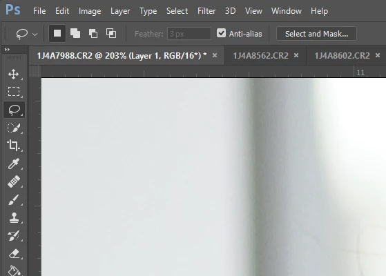

In the middle of a editing session, my feathering option for the lasso suddenly greyed out and now I can no longer adjust it.
perhaps I touched a key on my keyboard or something, I dont know. all I know is I can no longer adjust the feathering option for my lasso.
Polygonal Lasso, rectangular marquee tool and others still offer the feathering option. but my regular lasso will not. it is very obnoxious.
Can someone explain to me how this could happen, what did I press, what did i do to cause this?

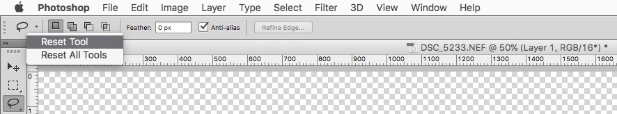

Reset the Lasso Tool by right clicking on the lasso icon in the tool options bar and clicking on Reset Tool.
