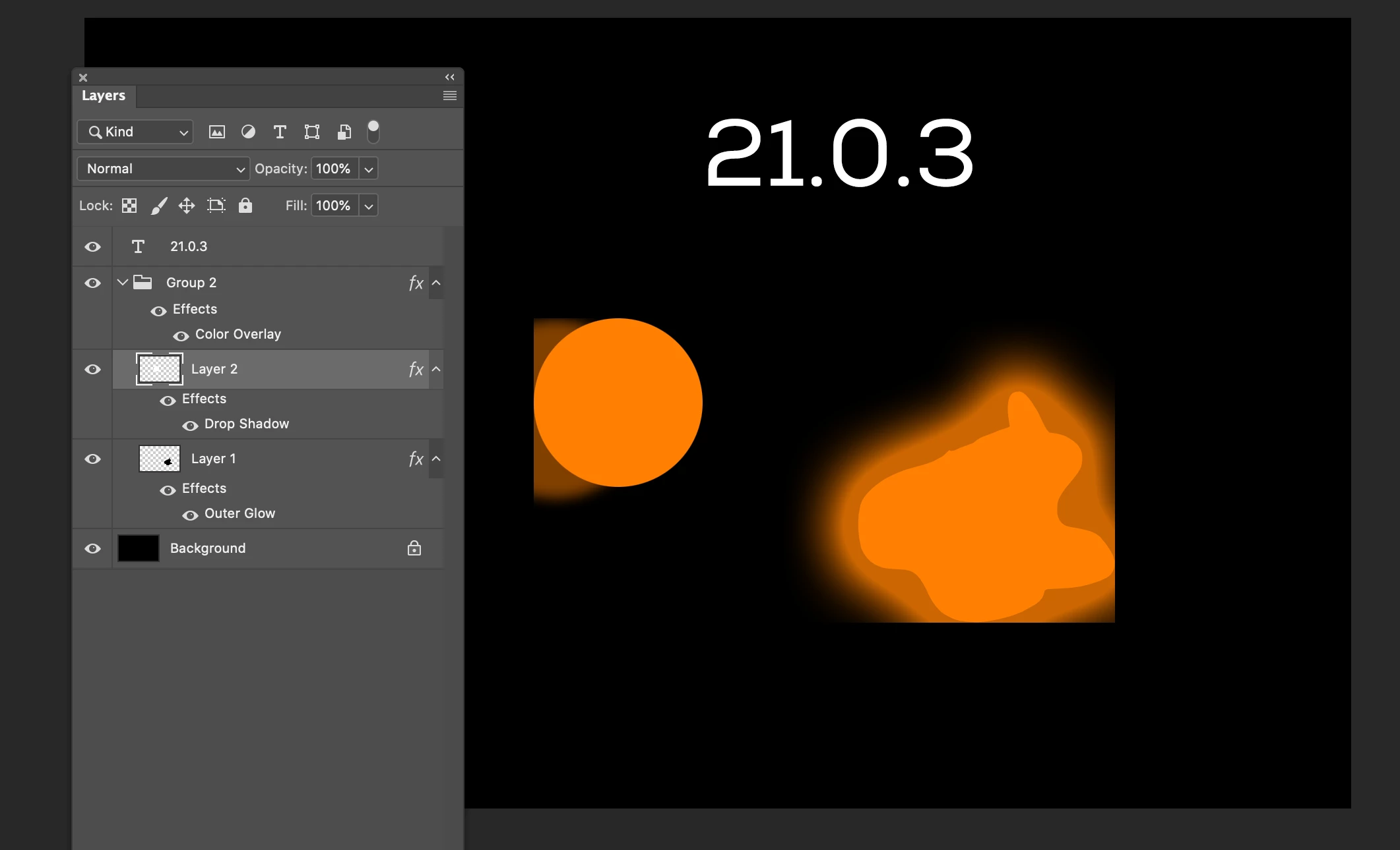

The image below shows a bug where the effects are cut off when placed into a group with a layer effect applied to it...

garethw48589654
January 24, 2020
@_cpfaffenbichler,
"Photoshop > Preferences > Performance > Legacy Compositing"
That fixed it!
Thank you! this fix saved me from performing a workaround on dozens of layers. The example I posted was just made to isolate the bug, but the real file it surfaced in is an automotive UI, that I've spent 3 months on, with hundreds of layers and nearly a hundred layer comps. The work around would have taken days if not weeks.

c.pfaffenbichler
January 24, 2020
I can reproduce the issue (21.0.3 auf Mac OS 10.15.2).
You may want to search for an existing Bug Report over on
https://feedback.photoshop.com/photoshop_family/
and if none should exist post a new one.
A work-around would be converting the Layers in the Group to a Smart Object.
