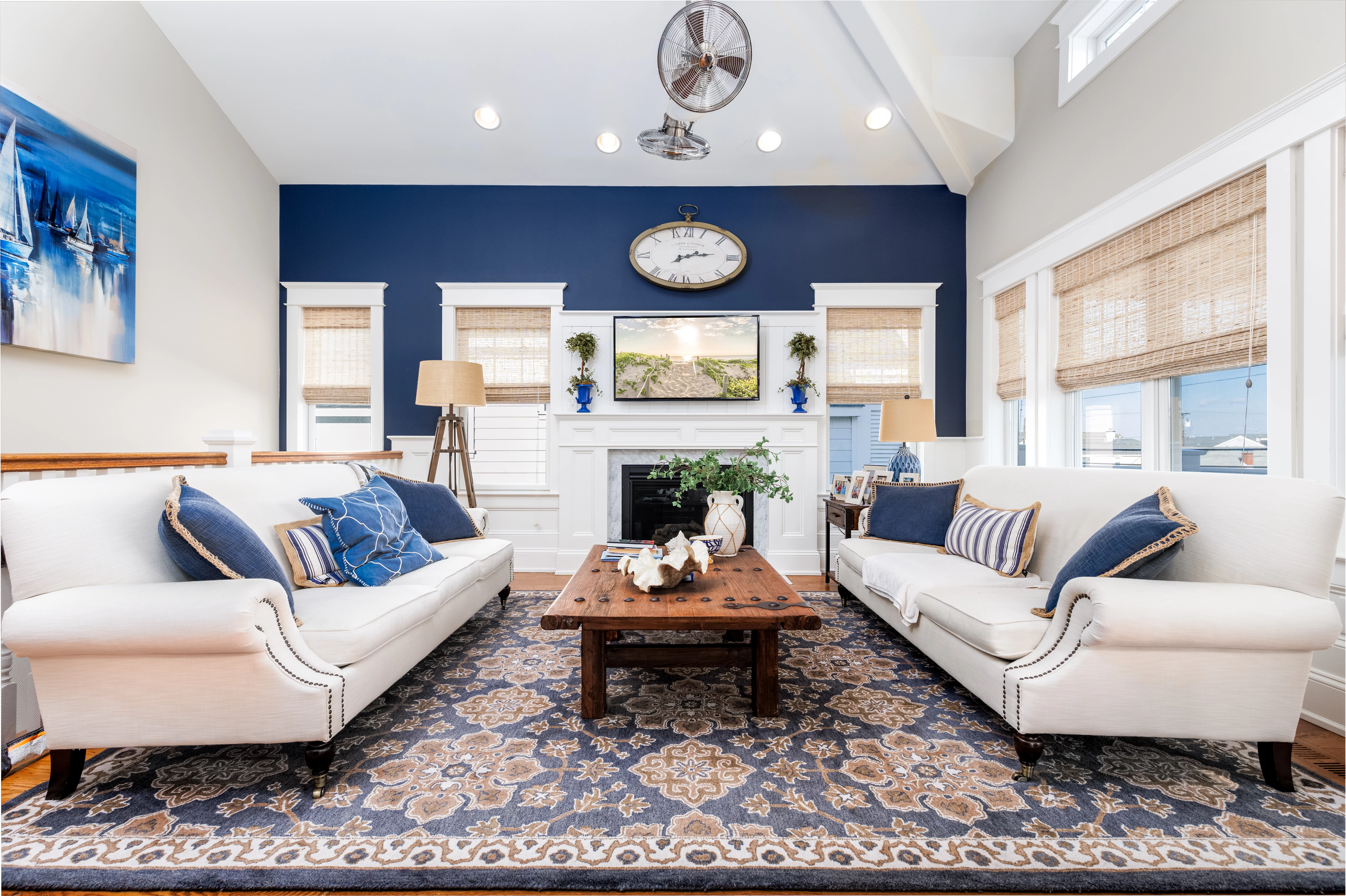

Hello, hopefully someone can help because I am at a loss on this one. I am compositing real estate images on photoshop and blending ambient and flash photos, with my ambient shot in luminosity mode I apply a layer mask and brush out the shadow of a ceiling fan, and there is a faint yellow tinge where the fans shadow once was. no amount of brushing or desaturation eliminates it. it seems to be an issue with the ambient shot in luminosity mode because when i change it to normal, with the same masking I do not have the issue. any help?? Photo attached, see the upper right area of the ceiling
Thank you in advance.
Andrew

With the ambient shot in luminosity mode, the color component is entirely from the flash exposure. It is not unreasonable to expect a color shift from deep shadow to highlights. Reflections off nearby surfaces will do that.
So the why is no mystery.
In cases like this, I usually put a steep Curves layer on top, to mercilessly exaggerate all problems. Then it's often easier to see the best way to fix it. Maybe painting on a separate layer above the flash exposure is enough - you can set it to Color mode, but as long as the top layer is Luminosity, anything underneath will automatically take on the Color property.

Thank you for this response and you are absolutly correct regarding the colors and luminosity mode. That makes perfect sense. In regards to the fix, I will experiment with your suggestions. Since I was under a crunch I just moved it out of Luminosity into Normal mode and dropped the saturation of the yellows in the ceiling. I really appreciate your quick and logical response!

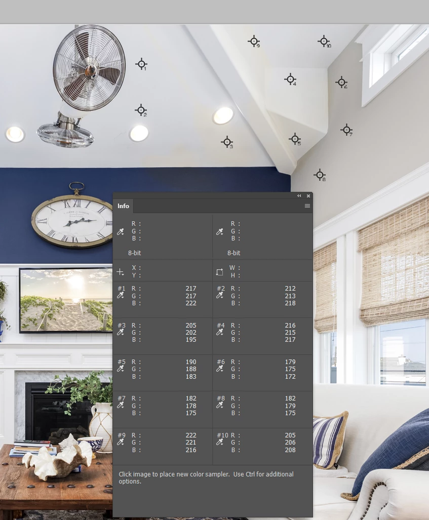

It might be helpful to see your layers, but withtout more information, I would set up some color sampler points, turn off all the layer masks, and isolate each layer in turn while watching the values in the Info channel.  It seems reasonable that the flash lit layers will be closer to the slight blue tint in the rest of the ceiling.  If I find that I would copy the relevant are to the top of the stack, and feather any layer mask to get a soft transition.
The problem AFAICT is that the affected aera is rather irregular, so difficult to select.  Color Range was not doing it.  It's not even easy to paint out, and I don't know if you'r be allowed to use that sort of fix/content in a realestate image.
