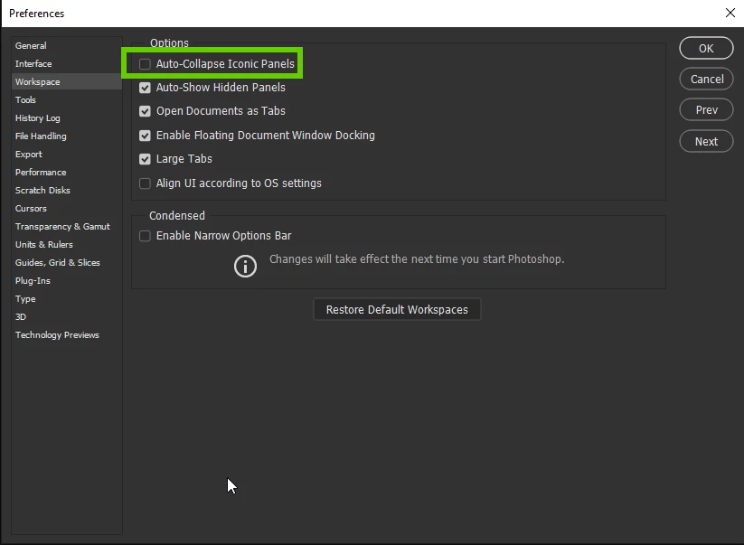

So far this option seems to be working for me:
Right-click on one of the tabs and choose "interface options" (Edit-->Preferences--Workspace) then deselect "Large Tabs"
After choosing that option I am able to have my swatches, color, and layers panels open.  Unfortunately I do have to right-click "minimize" my swatches panel when I am done with it, but I can live with that.  Hope this helps someone!

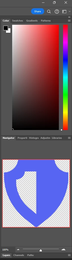

Jul 9, 2024 4:05 PM UTC
I have a 1920x1080 monitor resolution set and PS still loads with the Layers panel minimized and the Color / Navigator panels ridiculously large. See attached screenshots.

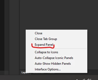

May 12, 2020 3:04 AM UTC
I don't know if you found a solution but I have had the same problem irritating me for a long time.
Right click the Layers tab while it is collapsed/minimised and hit Expand Panel. You never find it because you probably try finding the setting AFTER you have expanded it like I did; so if its expanded, hit Minimize, and then Expand Panel afterwards. I assume it will keep after you save workspace but no promises.

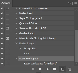

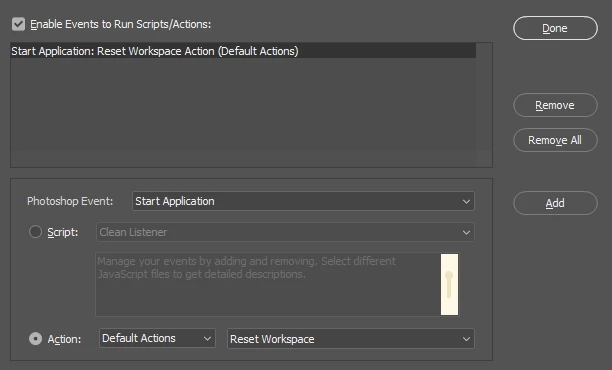

Oct 31, 2020 4:58 AM UTC
Hello, I've been having this problem too. Today I came up with a workaround by resetting the workspace every time you start. To do this first save your workspace with the Layers panel open, then open up Actions window, create a new Action, reset the workspace, open up Actions window again and stop the recording.
Then go to File > Scripts > Script Events Manager, tick the checkbox Enable Events to Run Scripts/Actions. On the bottom set Photoshop Event to Start Application, and set the Action to Reset Workspace (the one you just made), and hit Add.
Note that if you shift your workspace around you'll need to save the workspace again.

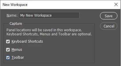

One thing I can think of that might help is to rearrange the panels and save a new workspace. Here's what I did, although you might want to modify it to work best for you:
  • Drag the Swatches panel to the same Dock as History
  • Resize Swatches to the desired height
  • Close the Swatches panel as in the screen shot on the left
  • Create and name a new workspace using the Workspace Switcher or Window > Workspace > New Workspace
  • Click Swatch icon to expand or collapse the panel. Your Layers panel should stop collapsing.
You might prefer other arrangements of your panels. This Help files tells you how to move and arrange panels and create custom workspaces.

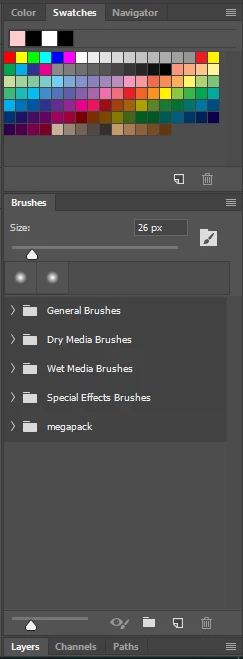

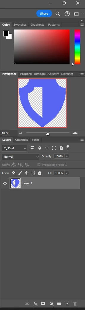

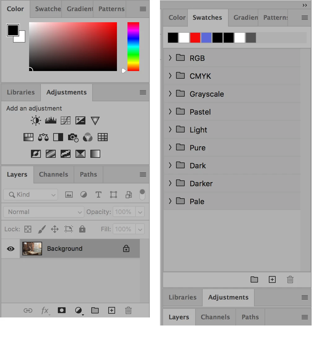

junea57597621
Jan 13, 2020 2:31 PM UTC
 This is how I rearranged after getting CC, both Layer and Brush panel opened.
 But when I switch to the Swatches tab, as you can see, the Layer panel has collapsed.
Something I also realized after posting the question is that in while the Swatches tab is active, the Brush and Layer panel can't be opened at the same time. If I click on the Layer panel again after it collapses, it would open the Layer tab AND collapse the Brush panel, and vice versa. This is really annoying and if you can help me, that'd be awesome, thank you!!
Jan 12, 2020 2:25 PM UTC
Hi
Is this option enabled in preferences by any chance
junea57597621
Jan 13, 2020 2:25 PM UTC
I checked and it isn't :'((((
