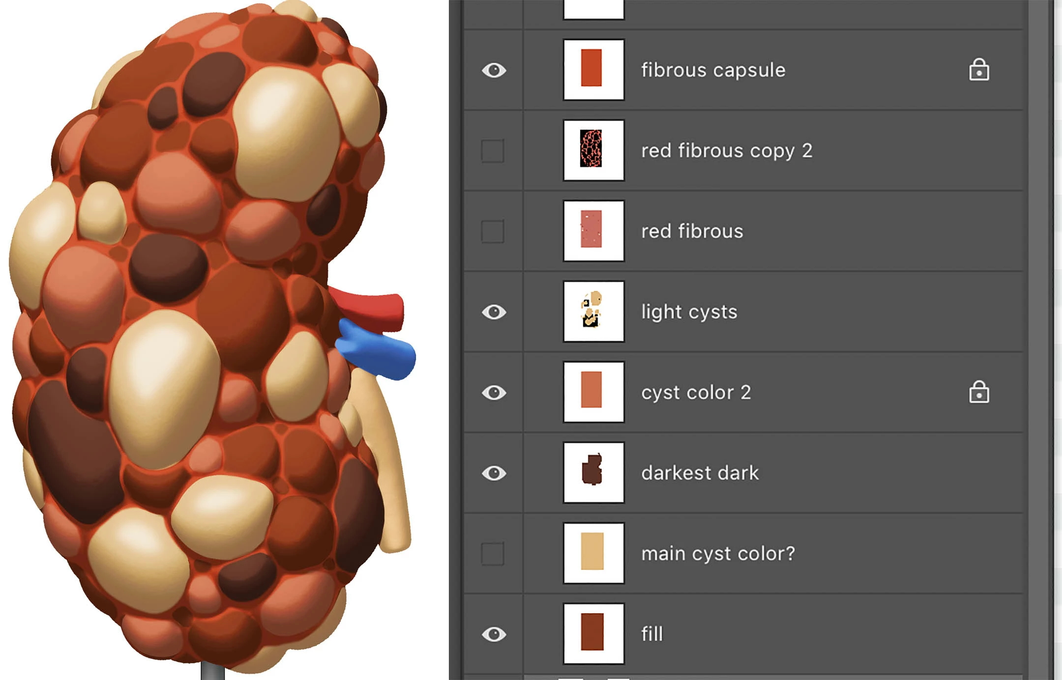

I have recently noticed that some layer thumbnails no longer represent the contents of the layer. Sometimes the thumbnails are solid black, even when the pixel content has only partial coverage in the entire image. I have noticed more unhelpful UI changes in recent iterations than in many years of Photoshop evolution.

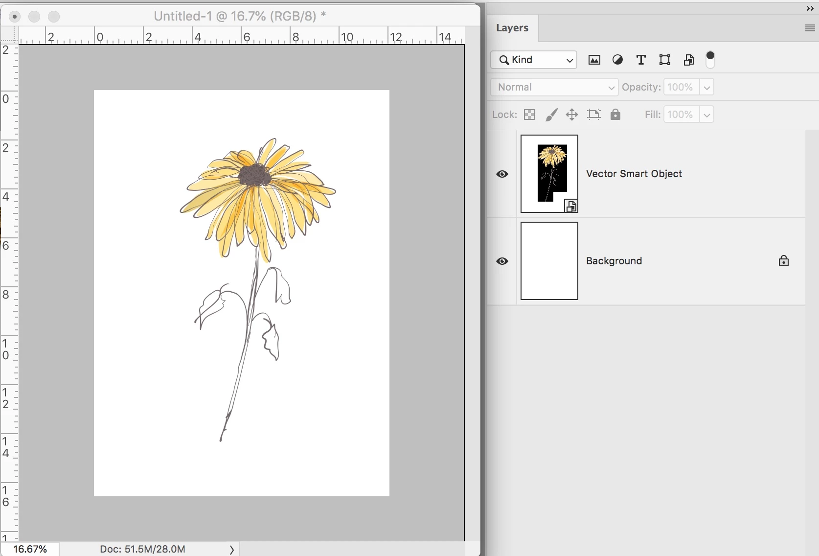

    I think I solved it. It has to do with Preferences > Transparency & Gamut. If you choose None, the thumbnail problems appear (Right below). Instead, I choose Grid Size Medium, and choose both colors to be white. (Left below)

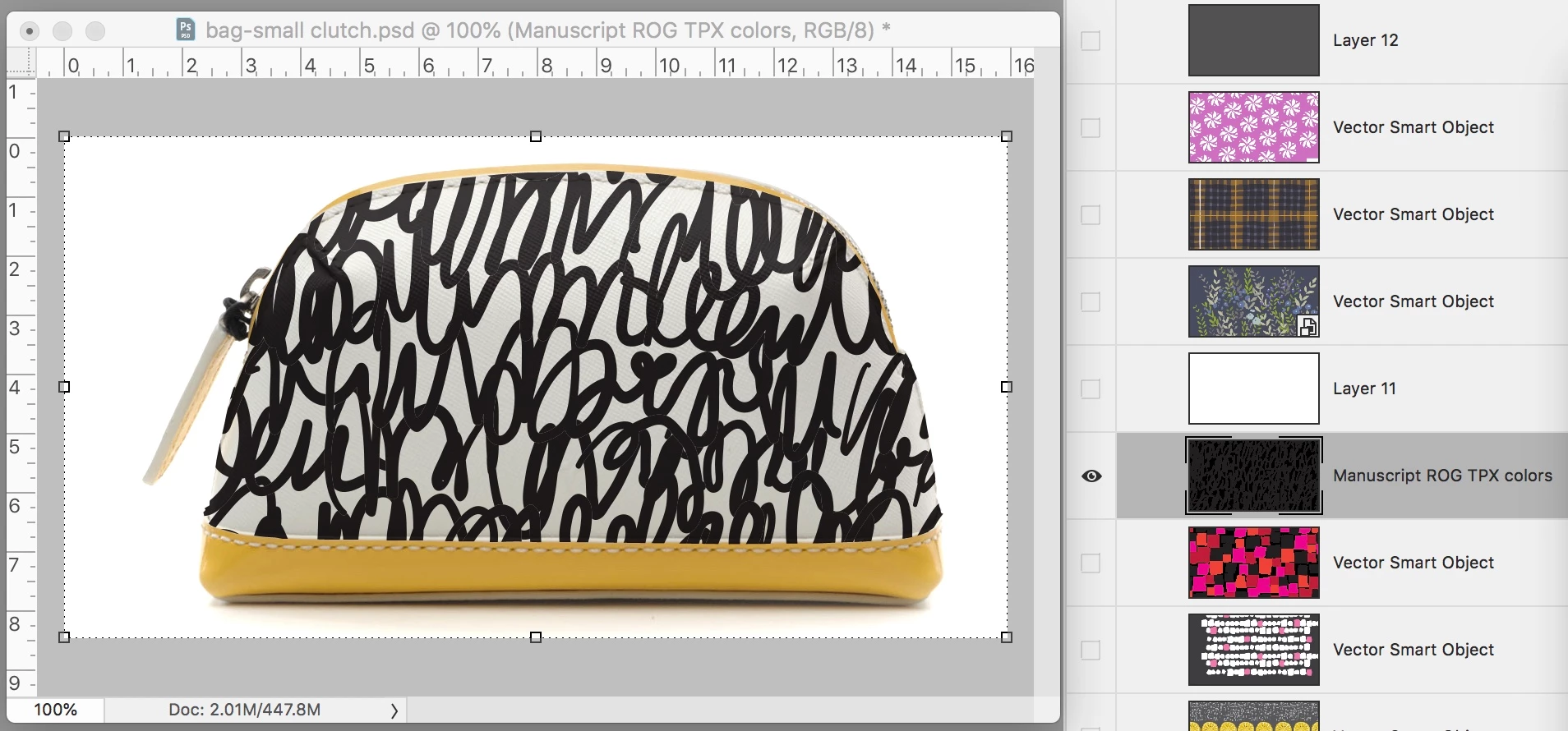

    Did anyone ever figure out a fix for this thumbnail problem. Whenever I copy and paste an .ai file with a transparent background into Photoshop, the thumbnail shows it with a black background. It kinda makes the thumbnails useless. The problem started with Photoshop CC2019 and continues with CC2020.

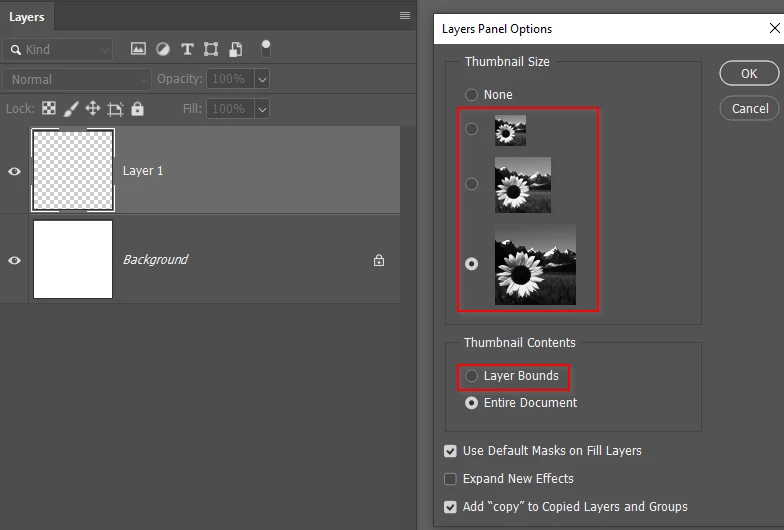

    My first thought is that thumbs might be set to Layer Bounds in the Layers Panel Options.  I don't know of anyone who works this way as it could get confusing, but I can see that it might well fit what you are describing.
    If you have plenty of screen space, then it makes sense to use Large Thumbs.  The only times I use smaller thumbs is when making frame animations with a lot of frames and layers, and when I need to get a screen shot of lots of layers to paste to a forum thread.  I use three screens, and have the periphery screens in Portrait mode.  That allows for a very tall layers panel. [1]
    It's worth noting that if this is what is going on, then a Preferences reset would have fixed it.  I am always loath to suggest resetting preferences until all else has failed, as it annoys me so much when I have to reset my own Preferences.
