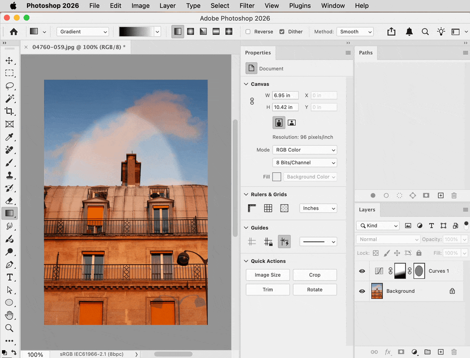

This sort of builds on Semaphoric’s good idea: The Properties panel may have sub-panels so that you can control the different components of a layer, so if what’s shown in the Properties panel is not what you expect for the selected layer, make sure the right sub-panel is selected.
In the demo below, there is a Curves adjustment layer that displays Curves properties as long as the Curves sub-panel is selected. But that adjustment layer also has a pixel mask, with a gradient on it, and a vector mask…three more components. So this adjustment layer happens to have a total of four sub-panels in the Properties panel, and you’re only going to see Curves properties if the Curves sub-panel is selected.
In general, if the Properties panel doesn’t look right, double-check both which layer is selected, and which component of that layer is selected, such as a mask. In addition, in the demo you also see that there are gradient tools on the canvas, and that’s because on that adjustment layer, the pixel mask contains a gradient and the Gradient tool is selected. When I switch to the Move tool at the end of the demo, the Gradient tools no longer appear on the canvas. So pay attention to all document, layer, and tool states.
