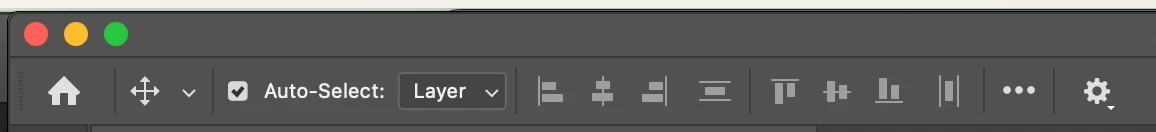

Jun 25, 2024 7:09 AM UTC
I was having this issue but fixed it by ensuring that Auto-Select is set to 'Layer' not 'Group' in the Move Tool options bar. Seems they may have changed the default to 'Group'.
XtrilliumCorrect answer
Jul 31, 2024 1:29 PM UTC
You are right, this was the problem, thank you
