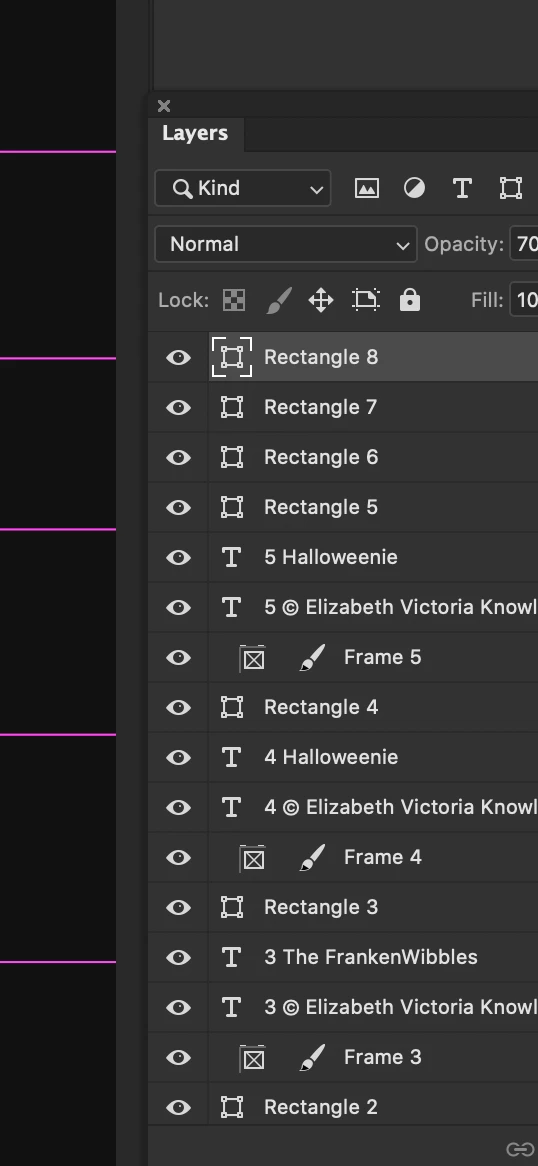

Thanks for your suggestion, I'm not familiar with Layer Comps and will look that up.  I don't think they're clipped, some but not all have image placeholder frames (not a photoshop expert here) - maybe that's the culprit?
I will try to get a screen recording, but here's a screenshot of some of the layers

Could you please post screenshots with the pertinent Panels (Toolbar, Layers, Options Bar, …) visible or better a screen recoding showing the issue?
