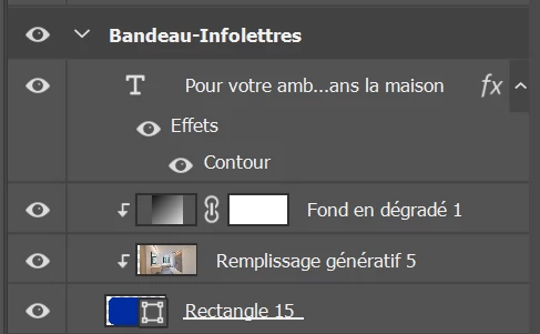

J'ai un problème depuis quelque temps. Le calque dégradé que j'applique sur mon plan de travail est visible lorsque que je travaille sur la photo, mais quand vient le temps d'exporter, il n'est pas là. Quelqu'un a déjà eu ce problème?

Could you share a bit more about your issue? What version of Photoshop are you using? Does this happen with other export methods like "Quick export" or "Save for web (legacy)"? Is it affecting all files with gradients or just this specific one? I tried testing it on my end but couldn't reproduce the error.
As a workaround, can you try flattening the gradient adjustment layer or converting it to a smart object and test if that makes it export correctly?

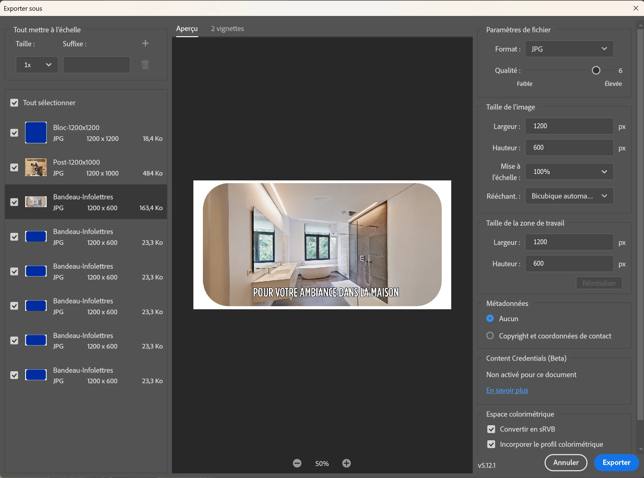

I'm using Photoshop version 26.5.0.
It does the same (no including the gradient) when I do a quick export.
It seems to keep the gradient when I do the Save for Web (legacy).
It affects every files for which I want to apply a gradient. The only way I found to make it work is to fuse the gradient with my image before exporting. But, that way, I cannot come back and change something if it is not ok.
Flattening doesn't work, I just convert every images I have into one big one without the gradient.
When I convert the gradient to a smart object, it works, I see it in the export preview. Thank you!
