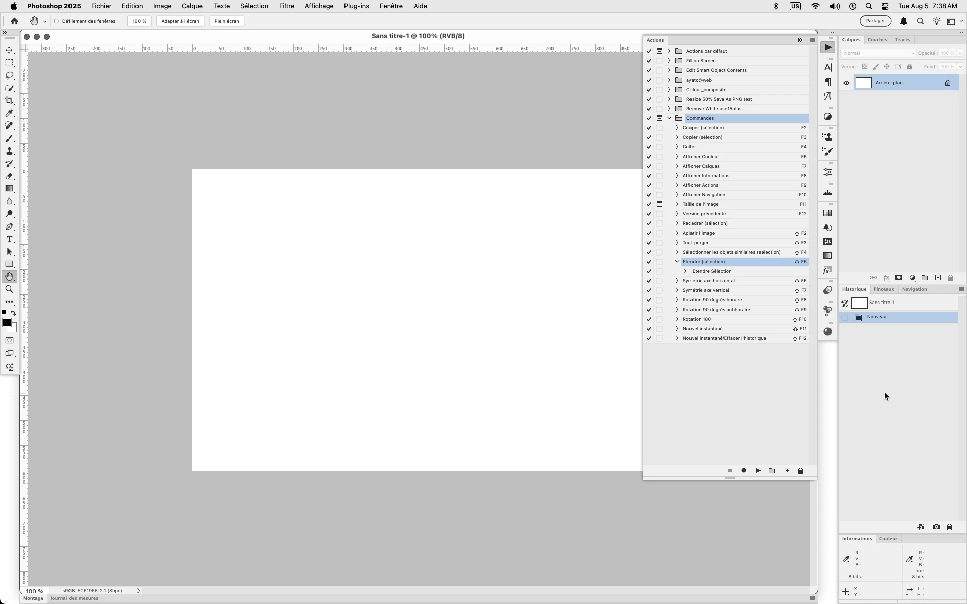

Check your Actions panel and see if you have the Commands set loaded, which has a shortcut of Shift+F5 for Grow (Selection) or on the Select menu as Select>Grow, that takes over the normal Shift+F5 shortcut of Edit>Fill.
Aug 5, 2025 12:10 PM UTC
yes ! That's it ! Thank you ^^
I love to understand why a problem exists 😊
Thanks again !
