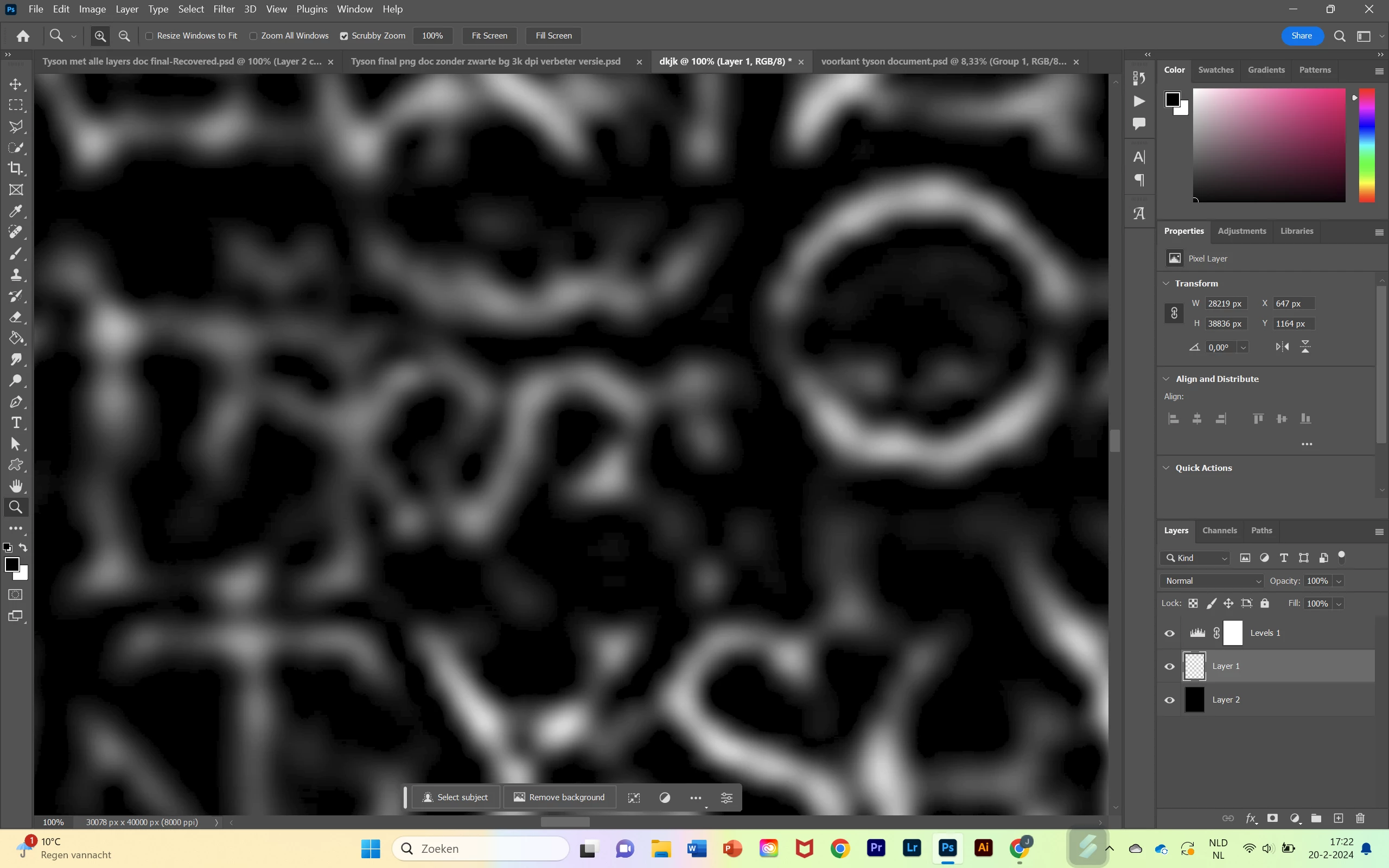

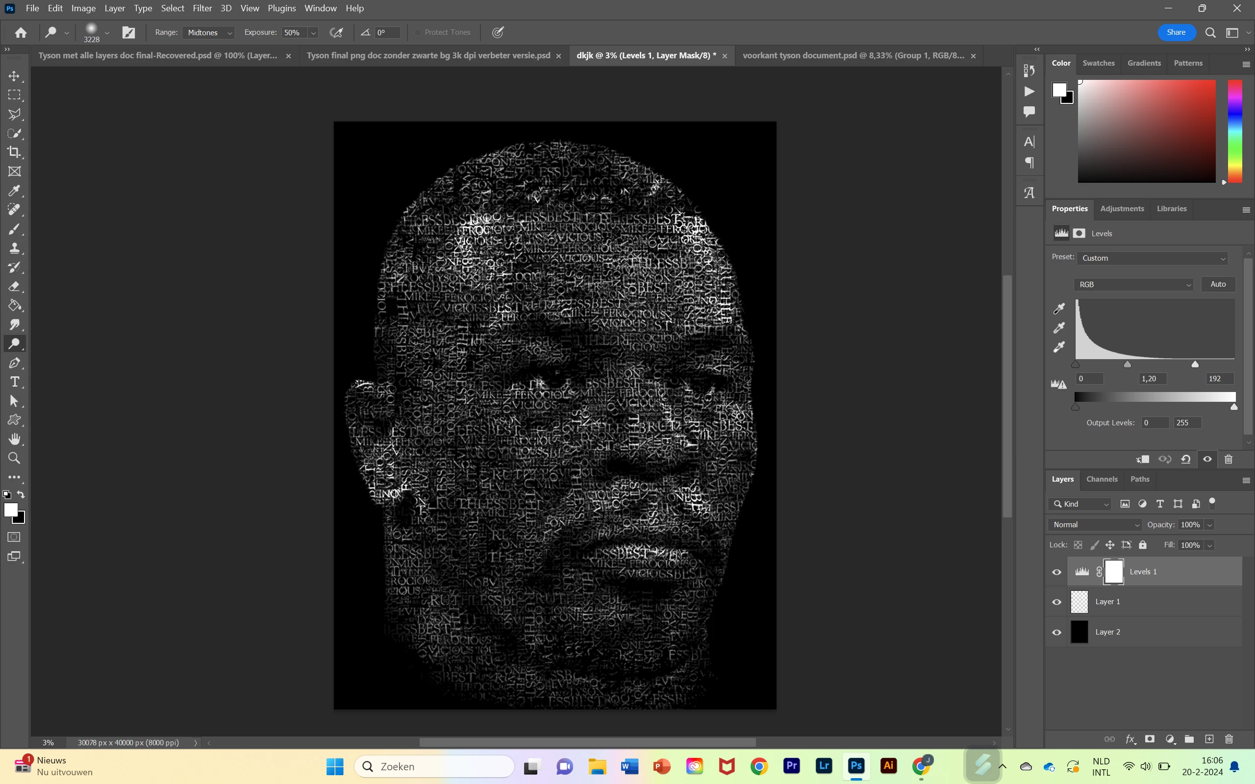

So I basically have a design that I want to put on clothes but the samples came out too dark so I wanna brighten them up. I did my thing and I'm now satisfied with the result, but the problem is that when I wanna merge the levels with the png layer they seem to undo themselves and the picture is dark again. I also have the feeling that when I undo the background layer which is a black background behind the png the levels also don't seem to work... Does anyone know how to fix this? Thanks in advance.

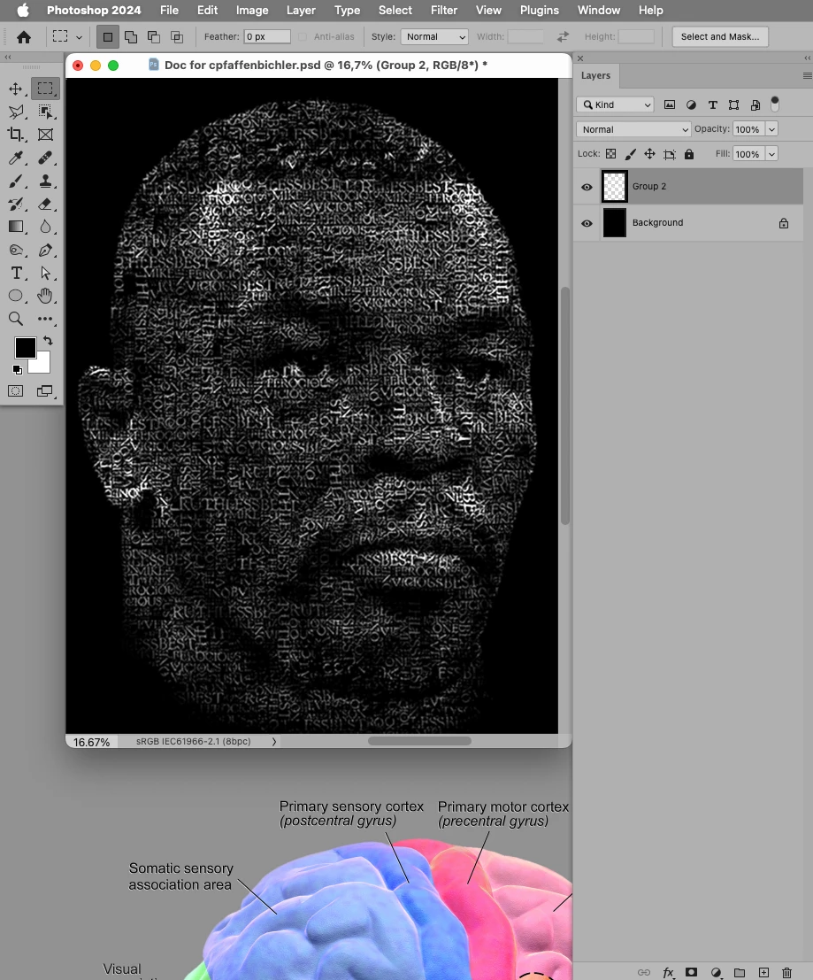

c.pfaffenbichler
February 21, 2024
The easiest approach might be loading the Selection (ctrl-click the Channel’s icon in the Channels Panel) etc.
February 21, 2024
I made it smaller cause the file size was first 700mb and now 40 or something so the quality is bad, but that is fine for you to check right? Thanks in advance.
c.pfaffenbichler
February 22, 2024

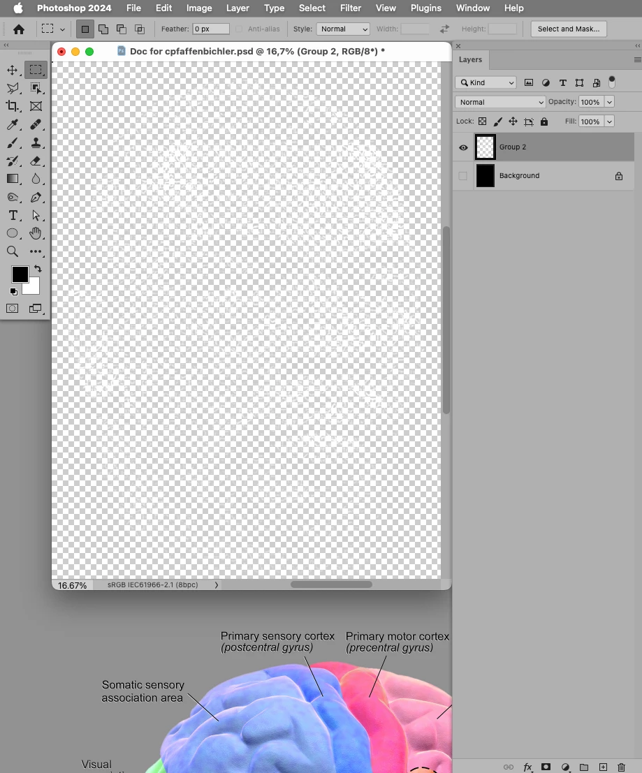

So the Layer »Layer 1« is purely white and the Adjustment »Levels 1« has no effect on white.
I have presented a work-around by loading a Channel as Selection and using that as a Layer Mask.
Have you tried that?

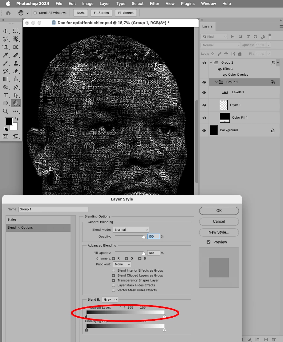

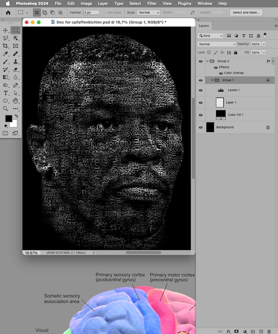

As for the Blend If/Color Overlay approach I attach screenshots to clarify the settings and Layer structure (to split Blend If-handles alt-click-drag them); the merged Group maintains the appearance, but I would recommend keeping the fully layered image:
What are the print service provider’s requirements?
Like I said I am not active in textile printing but from my experience with other print processes it seems dubious that transparency can play any role.

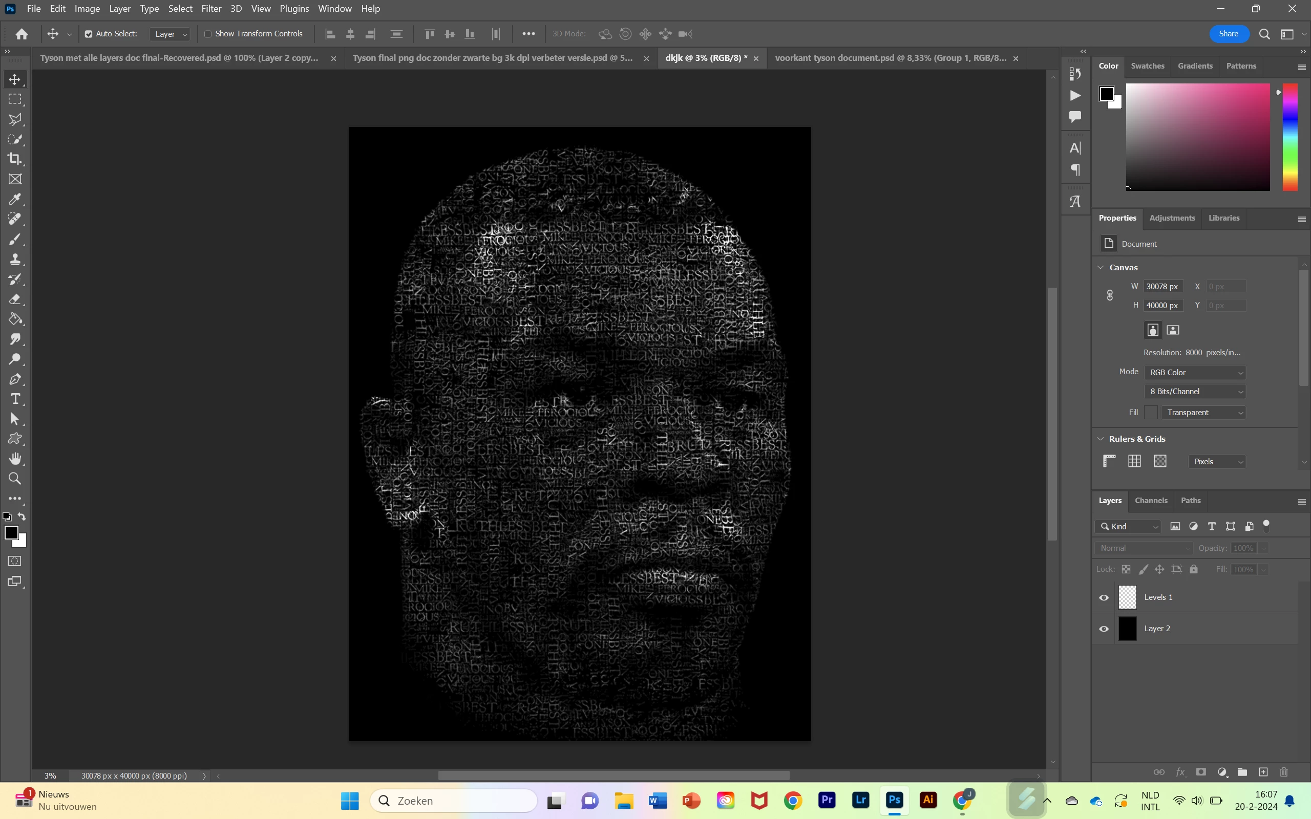

February 20, 2024
Thanks for the fast response. I have the same issue though when clicking on View - 100%
c.pfaffenbichler
February 20, 2024
You need to flatten the image to maintain the effect.
If you want to edit the transparency of Layer 1 an Adjustment Layer is the incorrect approach.
c.pfaffenbichler
February 20, 2024

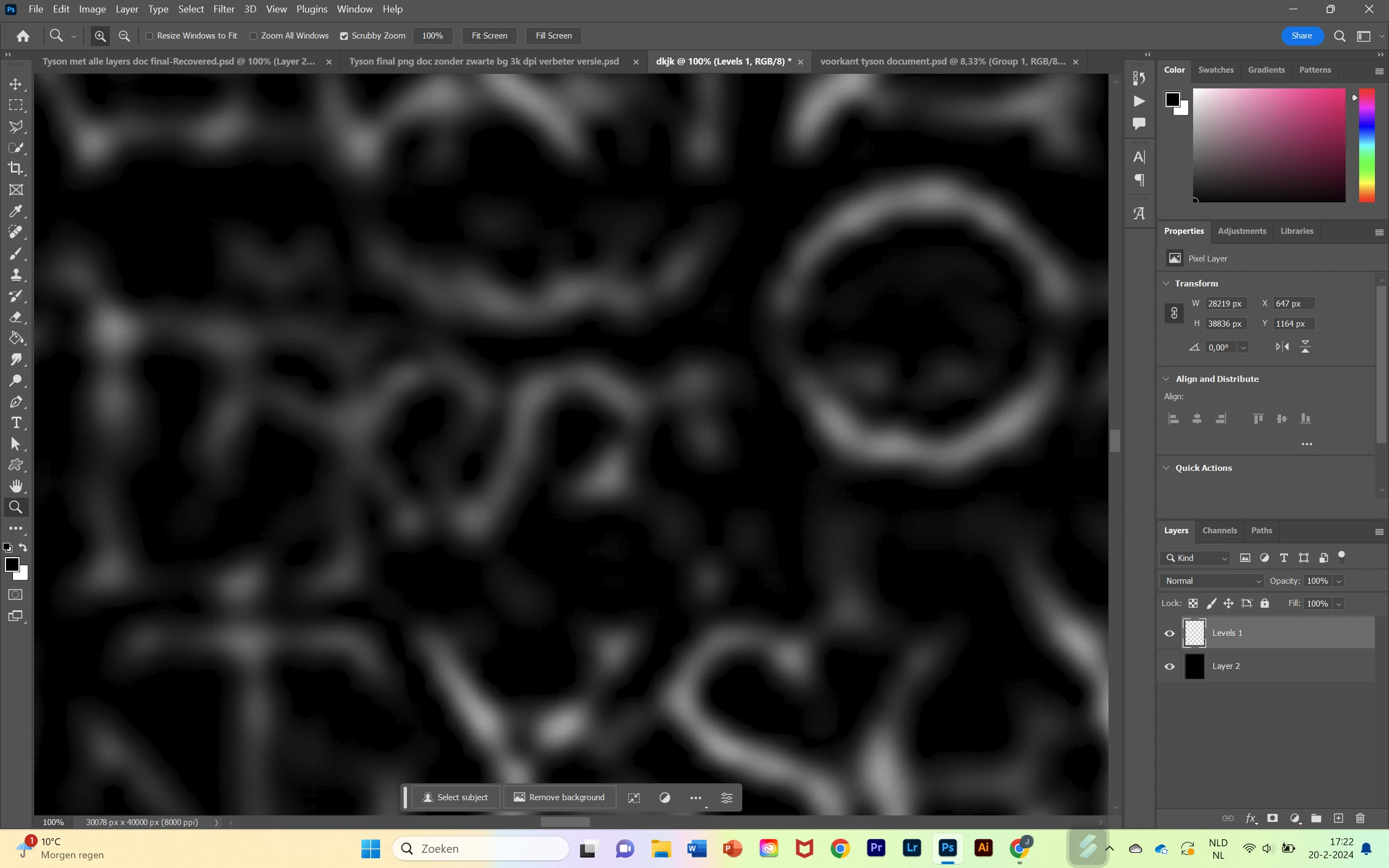

Could you please post screenshots taken at View > 100% with the pertinent Panels (Toolbar, Layers, Options Bar, …) visible?
February 20, 2024
I just did. I also seem to have the problem that when I delete or unsee the black background and then unsee or delete the levels layer, it doesn't even have an effect on the design anymore (it stays the same brightness as it was in the picture I showed you). Maybe this is the actual problem instead of the merging thing?
