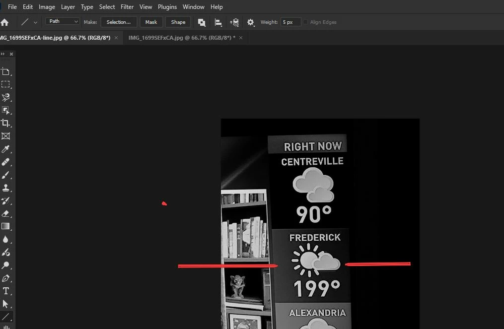

Just did the latest version update of PsCC.
Now LINE TOOL does not work. Yes it draws the line but when I go to save the jpeg, it does NOT show the lin
Just updated PsCC to latest version. Now Line Tool no longer works. Yes I can draw the line! It appears on the image BUT when I "Save Image(jpeg). The Saved file does NOT show it.
Line was drawn on 199F icon.
e drawn.

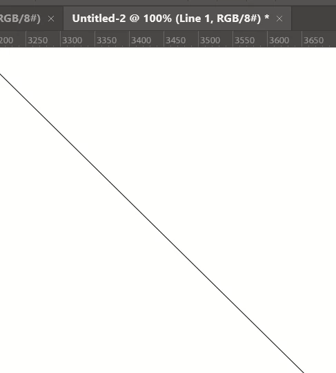

What is the pixel size of the document you are working on?
What are the line settings?
The way to think about this is if your document is fairl big — say 4000 pixels square, and the Line tool was set to 1 pixel, then the line is likely to appear fiant if you are zoomed back from the image, and very unlikely to show in a thumbnail (in Bridge for instance.
If I zoom in to 100% then it becomes easy to see.
Is that is what is going on?
Otherwise, what is the layer opacity?
Does the line color have good contrast with the background?
Are there other layers further up the layer stack that are hiding it?

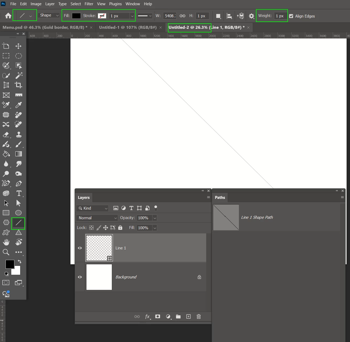

Looks like in your screenshot the Line Tool is set to draw a Path.
In the tool options bar set Shape for the tool mode before drawing out the Line Tool.

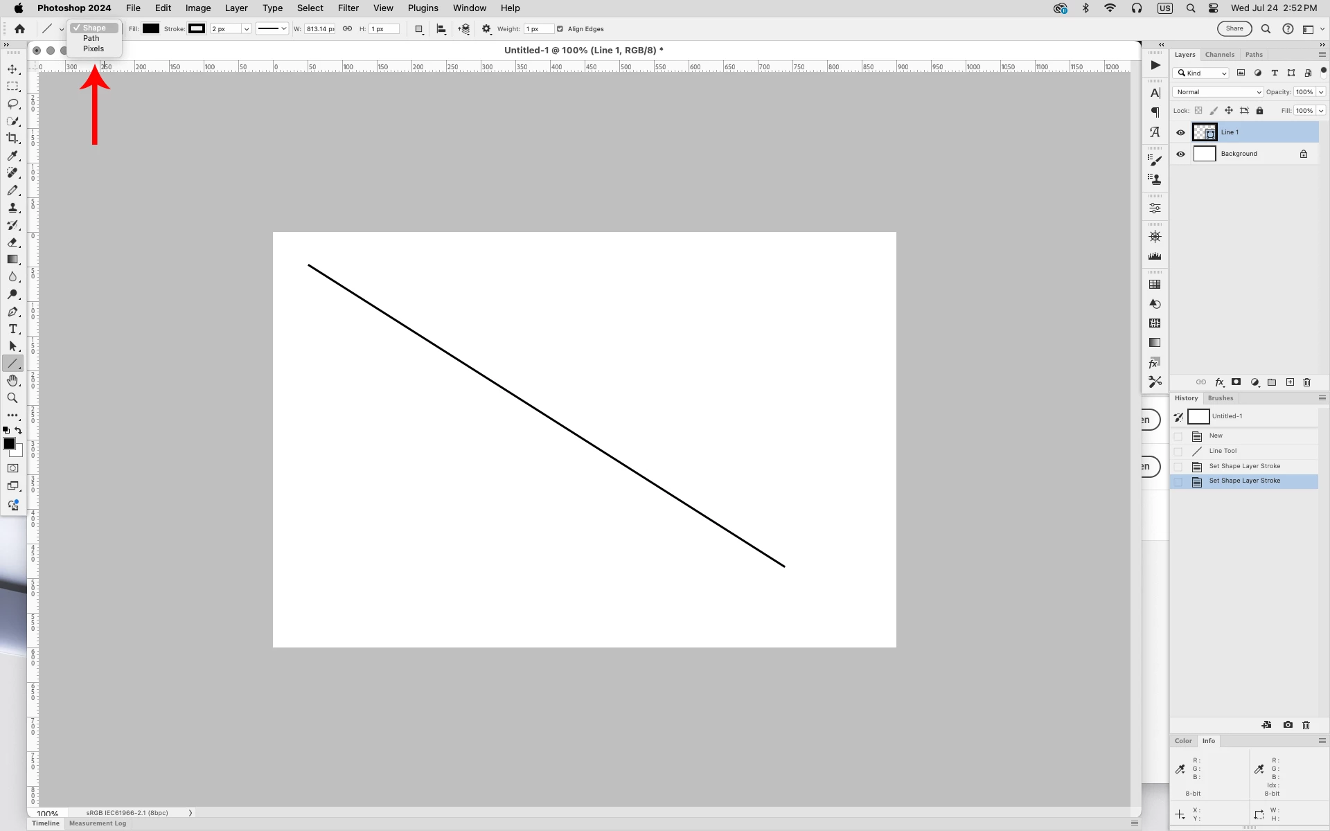

I don't see any issues on Windows running the Photoshop 25.11.0 release.

The jpeg file when opened shows the arrow/line... In Bridge the thumbnail does not.
Here is screenshots!

c.pfaffenbichler
July 24, 2024
Have you tried setting the Tool to »Shape« (as per @Jeff Arola ’s screenshot)?
