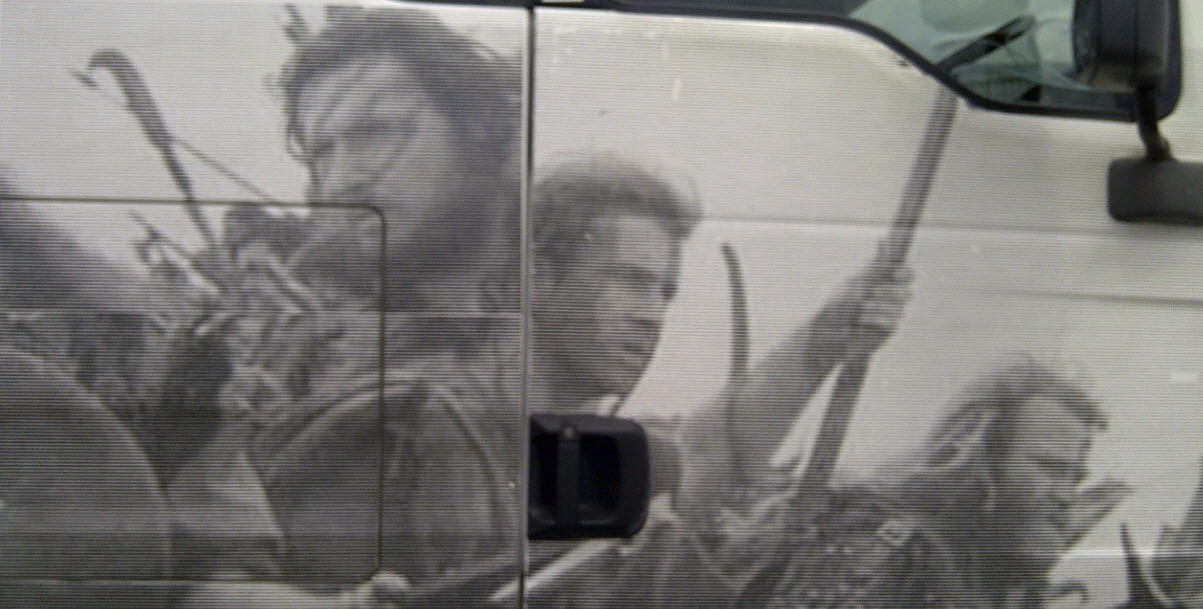

I am trying to get a good linear Half tone but I'm not getting very far. I have attached 2 images. One image shows the linear halftone cut in black vinyl from a distance and the other image is a close up. In the closeup, the larger parts are about 4mm thick. Whats important is that the halftone is smooth like the image, not the jagged edges that photoshop give me.

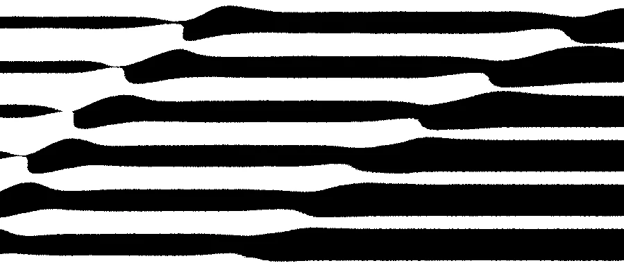

    What method are you trying now? I usually do it like this: Starting with a grayscale image, I first run Image > Adjustments > Curves to flatten the contrast of the mid-tones. Then I scale up the image to a high resolution, like 2400 ppi, with resampling checked. I then convert to Bitmap mode, with the resolution set to the same as what I had scaled it to, using Halftone Screen with the Line option, using a low lines per inch value, like 8. Finally, I convert back to grayscale mode.
    It looks like this (at 100%)
    The problem is the image is now very large. I don't know how well it might work in Image Trace in Illustrator. You might want to try asking in the Illustrator Scripting Forum, Illustrator Scripting.

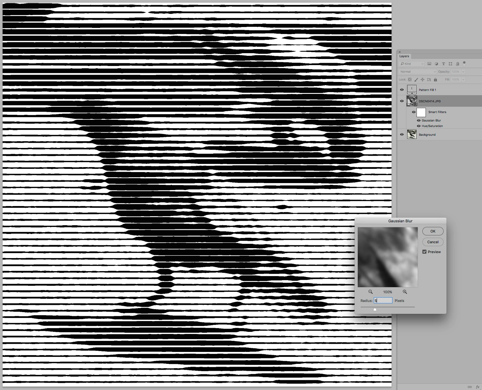

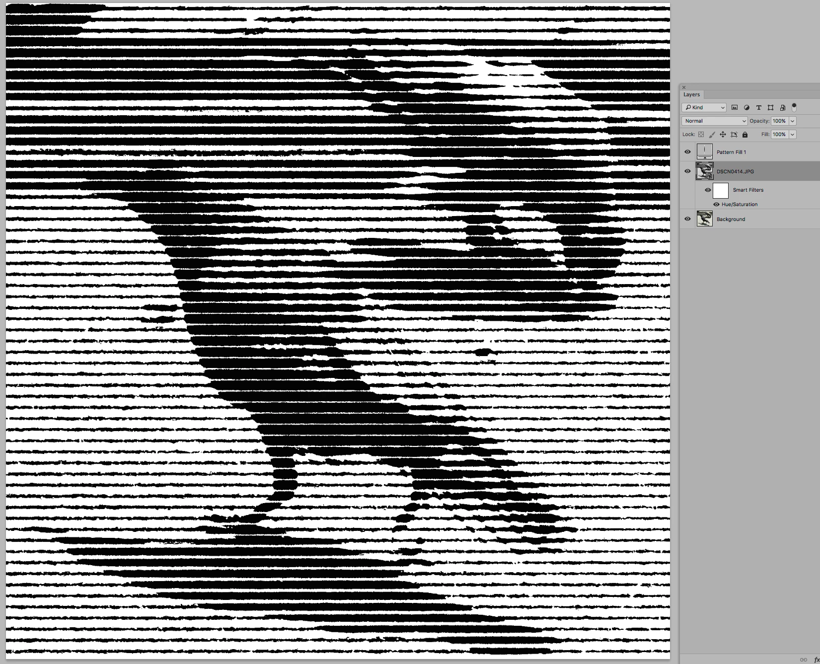

    Another option is using a Pattern Layer of a blurred line pattern set to Blend Mode Hard Mix and Gaussian Blurring the image underneath it.
    This could be done at higher resolution, converted to a Smart Object as a whole and that then downsampled as necessary.
