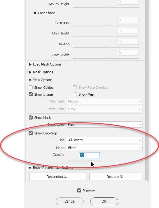

    Hi
    Have you got "show backdrop" checked in Liquify and have you adjusted the opacity controls?
    Dave

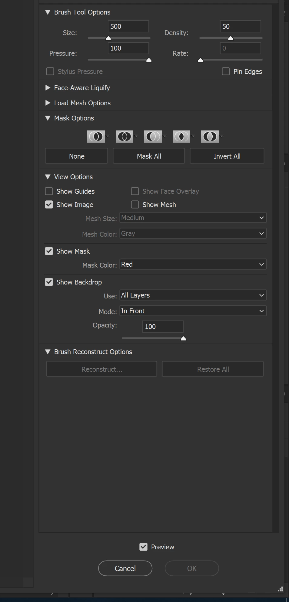

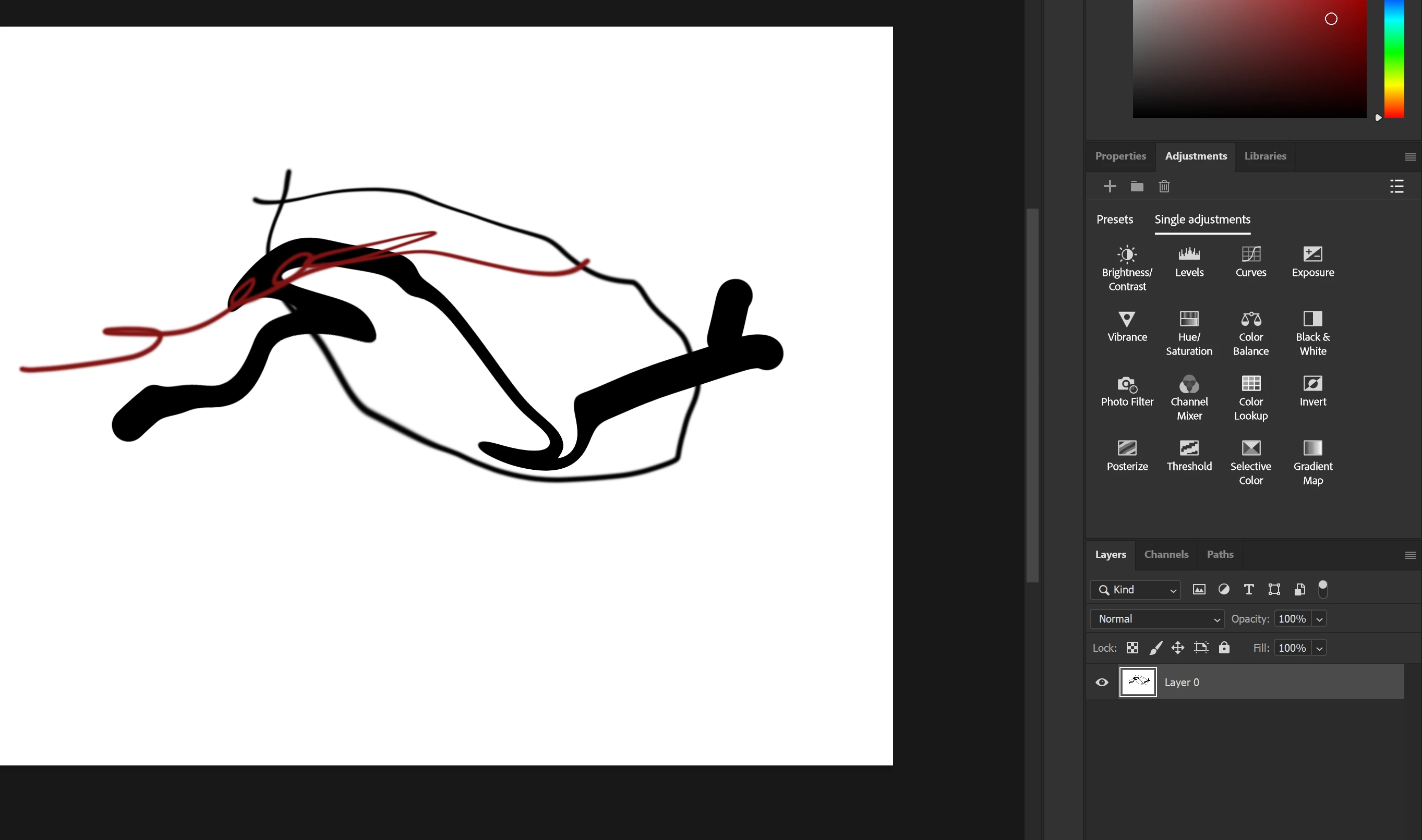

    Sep 1, 2025 4:19 PM UTC
    i am having the same issue.  i have made sure the layer isnt locked. the processor box is ticked in peferences. Also as per above  user suggestion i have show back drop ticketd etc. This tool was working fine about 2-3 weeks ago.
    when i move the pointer over the image in Liquify nothing happens to the image, but if i click ok,  and return back to the main screen in photoshop the image has distored as i would have expected  from the mostions i dont inside the liqufy tool.
    screen shot 1 - in the liquify tool
    Screen shot 2 - what i see  upon clicking ok and returningto the main screen
    any ideas?
    Simon
    Sep 1, 2025 4:21 PM UTC
    when i move the pointer over the image in Liquify nothing happens to the image, but if i click ok,  and return back to the main screen in photoshop the image has distored as i would have expected  from the mostions i did inside the liqufy tool.
