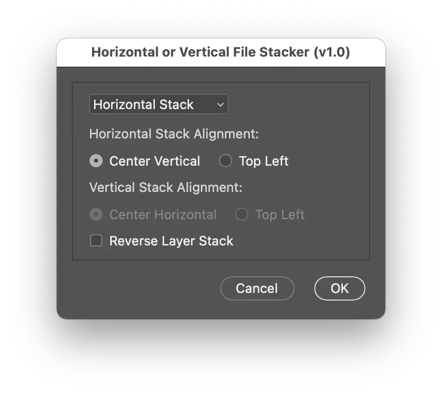

    Stack files to layers as horizontal or vertical canvas layouts:

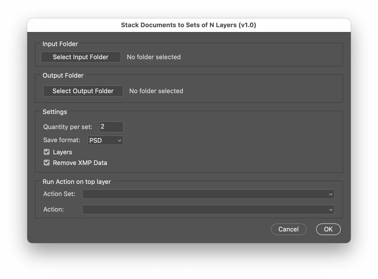

    Stack Documents to Sets of N Layers:
