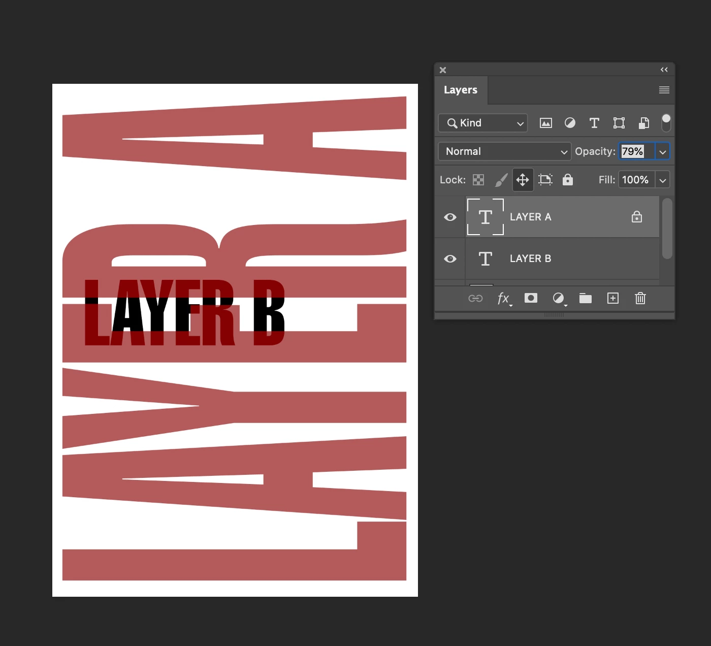

When a layer A is locked, and a lower layer B is alt dragged to make a copy, the higher layer A is copied and moved, instead of the selected layer B.
Correct answer c.pfaffenbichler
And why is Layer A selected anyway? Is the Move Tool set to »Auto-Select«?
June 16, 2020
Meanwhile, I found that turning off 'Auto-Select' is kind of a workaround.
c.pfaffenbichler
June 16, 2020
I had specifically asked about that setting …
September 20, 2021
old post but if you hit ctrl while alt-dragging it will turn off auto-select just so you can drag the right element. Of course you must have the right layer selected as well.
c.pfaffenbichler
June 16, 2020
Could you please post screenshots with the pertinent Panels (Toolbar, Layers, Options Bar, …) visible?
June 16, 2020
It happens when the toplayer is covering the bottom layer.
c.pfaffenbichler
June 16, 2020
I asked for seeveral UI elements to be included in the screenshot.
June 16, 2020
Hi
Can't replicate the issue here with Photoshop 21.1.3, what exact version do you have and what operating system are you using
June 16, 2020
21.2.0, but the previous version had the same issue.
