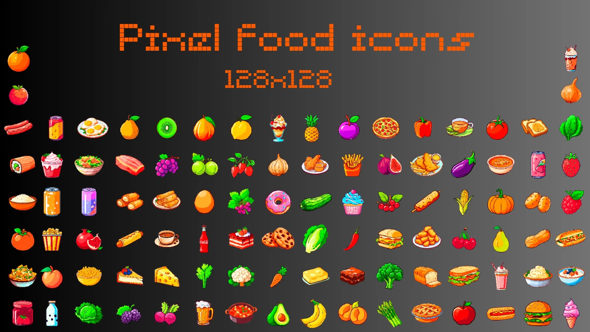

Pixel art should never be downsampled from bigger images. I would define 128 x 128 as pixel art.
Create it at 100%, actual size, using the pencil tool to avoid random anti-aliasing. To work more easily, zoom in to 200/400/800 % - even ratios that will not resample on screen.

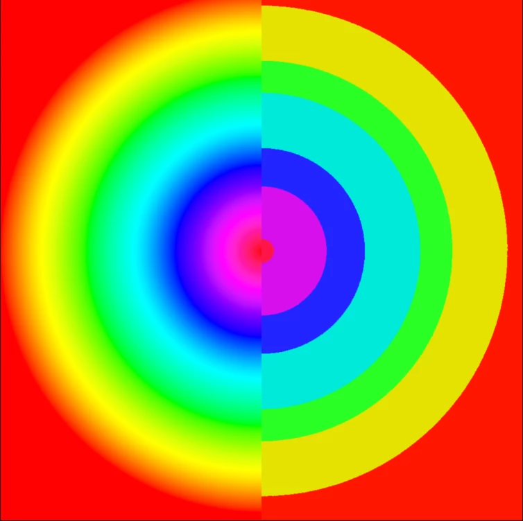

Dag, Bert Monroy creates his illustrations much bigger than their eventual size, but definitely not by a factor of 10.  I do the same thing because it is easier, and errors are diluted when downsized.  The example below was the windmill from #191
construction of an image element
Final Image

The one advantage you have AFAICS is that you are working with illustrations rather than photographs.  If you are able to simplify the illustrations, they might resolve better at the 128 x 128 final resolution.
You could reduce the number of colours with  Filter > Artistic > Cutout as shown below.
You could remove image elements that were not contributing to the story you need the reduced size icon to portray.  The new Remove tool and Content Aware Fill make that so much easier than even a very few years ago.
But the bottom line is you need to plan your illustration with the final size in mind.  Check out existing 128 pixel icons and
It seems to me that you can say a lot with 128 pixels square

A 128 x 128 px image has very little capacity for detail. Just imagine being told to build an image with Lego bricks or mosaic tiles, and that it cannot be more than 128 pieces wide or tall. It will be a very chunky looking image, because 128 is just not a lot of blocks to build a detailed image with.
Hopefully you aren’t making the mistake of viewing a 128 x 128 px image at higher than 100% magnification while editing. If this image is for an icon, thumbnail, or button, keep in mind that those are not typically magnified in normal use, so they should be previewed at 100% magnification, and can be made to look good at that magnification.
If you’ve seen an example of a 128 x 128 px image at a level of detail you’d like to achieve, post it here so we can advise on what kinds of sharpening and edge/contrast enhancement it might have had. But chances are, even other good examples you find will look great only at 100% magnification and not higher.
