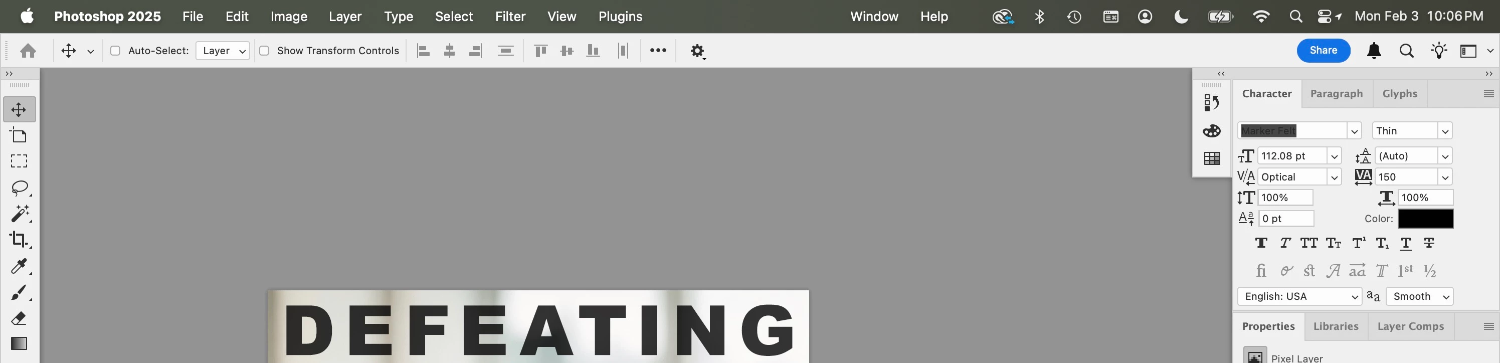

I touched something on my keyboard by mistake, and now all my open tabs are gone. I still have one of the .PSDC file open, but I do not see its name at the top either.
How to get back to my missing tabs (with the names of the opened files)?

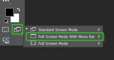

I think you might have tapped the 'F' key.

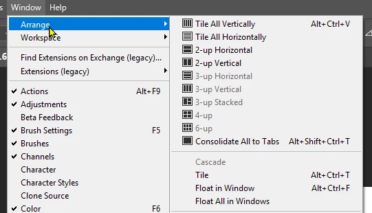

You may have accidentally hidden the document tabs or entered a different screen mode. Try pressing Tab first, as it can hide the panels and tabs. If that doesn’t work, check Window > Arrange > Consolidate All to Tabs to restore the open document tabs.

FYI There is another Photoshop gotcha that can hide all of your documents.  If your document window is floating, you can minimise it and it can be a bugger to get back.  I use some of the Michael Ninness Power Shortcuts from his MAX workshop in 2014 (I think).  Consolidating all docs back to tabs makes even minimised floating windows reappear.
They withdrew Michael's video from YouTube because some of the shortcuts and tips would have been confusing after changes to ACR.  The Shift Ctrl Alt T shortcut also breaks Transform Step & Repeat, so I save the custom shortcuts with a workspace, and return to Essentials when I need T S&R.
