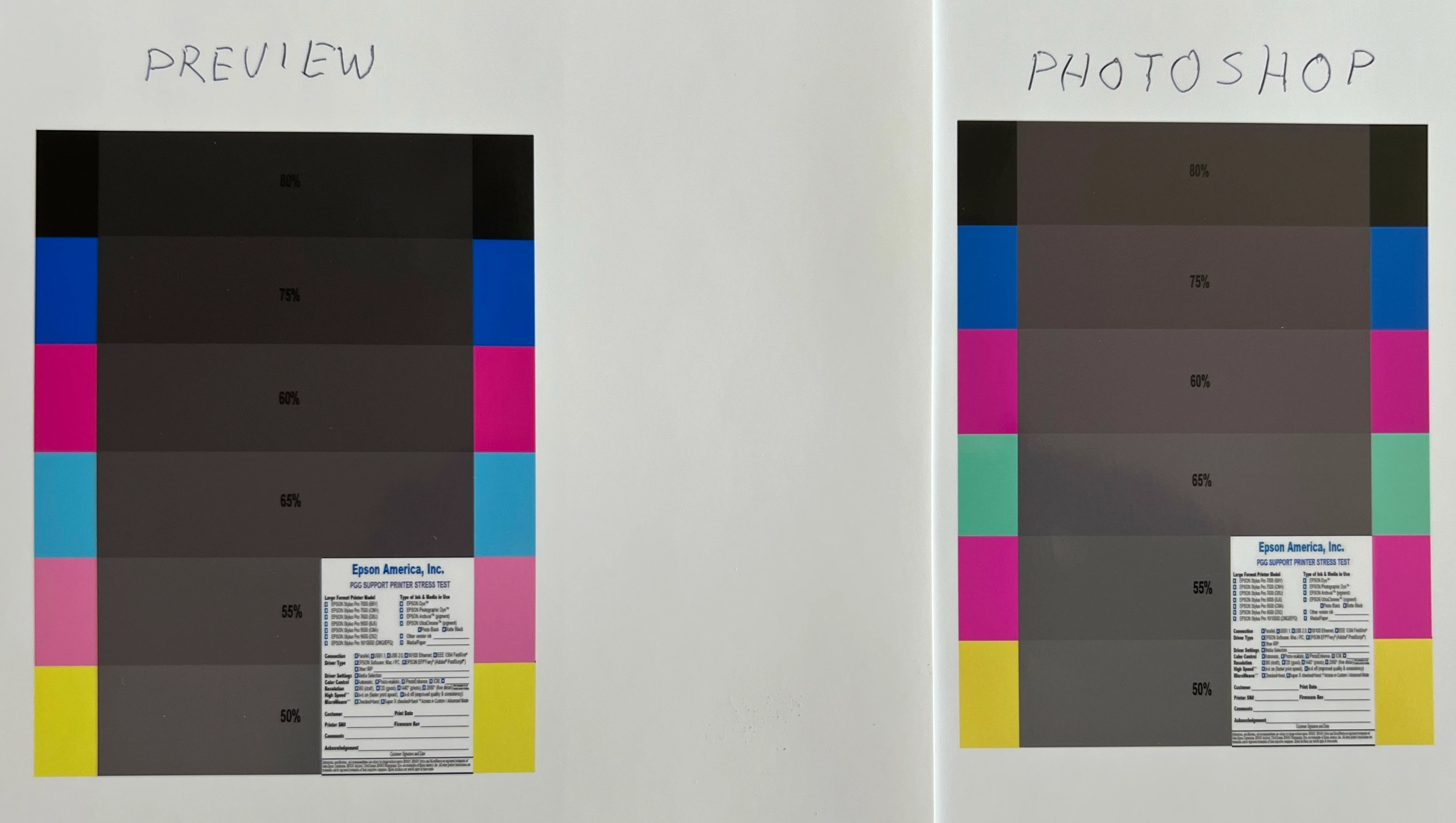

I've been back-and-forth with Epson support about this . They had me make a print of a test image they supplied with Photoshop and also another app. I used Preview. Here are the results, side-by-side:

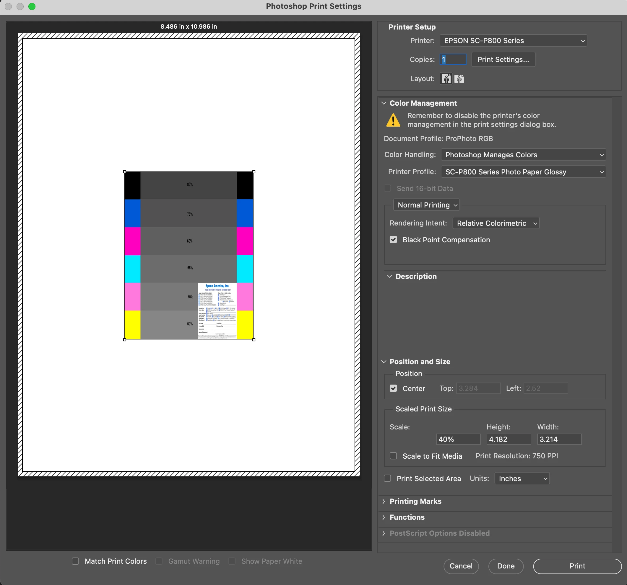

Epson and I both think the magenta prints are from double color management. Here is a screenshot of Photoshop's print dialog:
